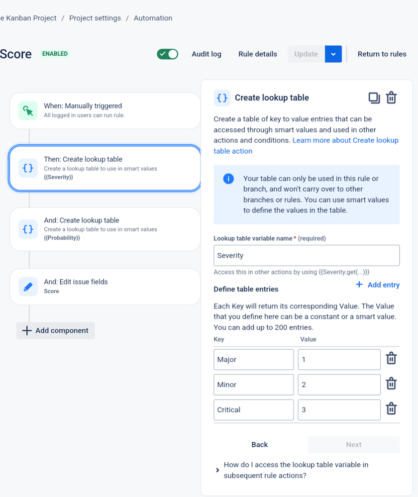

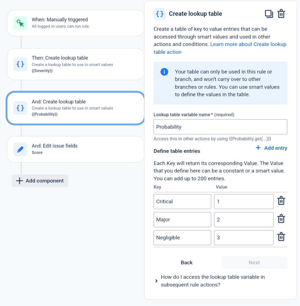

Hi @thumuluru.shreya , thanks for your question.
I'm doing something like this for two of my customers using lookup tables. The benefit of this approach is that you can modify easily the number / weighting associated with each value.
So, you create a lookup table for each custom field and insert the mapping / weighting.
Then, in the action, you need to get the custom field ID's and then should be able to insert this calculation
{{#=}}{{Severity.get(issue.customfield_YOURID)}} * {{Probability.get(issue.customfield_YOURID)}}{{/}}
Please have a go on your instance and share your feedback.

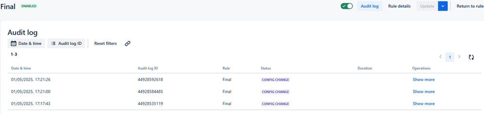

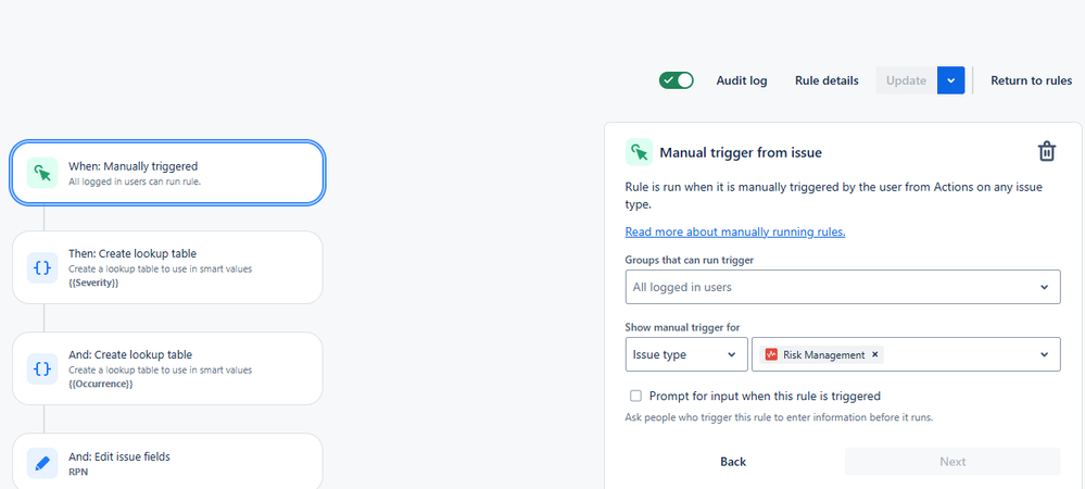

thumuluru.shreya
January 5, 2025
@Valerie Knapp , Please check I performed an action but there is no results showing on that in audit log.
Valerie Knapp
January 5, 2025
Hi @thumuluru.shreya , thanks for sharing the rule.
Can you try to please to change the trigger to something else, like an issue update or transition and see if you can get it to be called?
Cheers

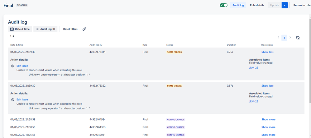

thumuluru.shreya
January 5, 2025
Hi @Valerie Knapp , I checked these conditions I am getting an error. Could you please help in this
Valerie Knapp
January 5, 2025
Hi @thumuluru.shreya , thanks for sharing the audit log.
Please can you copy the formula you have in the action for the field RPN? The audit log is saying there is a mistake in the formula syntax.
Cheers
thumuluru.shreya
January 5, 2025
Hi @Valerie Knapp , This is the formula I used
{{#=}}{{Severity.get(issue.customfield_10324)}} * {{Occurrence.get(issue.customfield_10325)}}{{/}}
Valerie Knapp
January 5, 2025
Hi @thumuluru.shreya , thanks.
Please can you remove the spaces either side of the * and try again?
Cheers
Bill Sheboy
January 5, 2025
That error indicates two things:
First, when accessing the selected value for an option field, the default is to return the option's id and not the value.  When you want to use the value in the get() function calls, that should be:
{{#=}}{{Severity.get(issue.customfield_10324.value)}} * {{Occurrence.get(issue.customfield_10325.value)}}{{/}}
Next, from your original question, the values look like this: 1-Major, 2-Minor, etc.  And those values do not match your lookup table keys, so they will not match.
This is why I suggested using text functions and a math expression earlier.  Let's assume the first character of each of your select-option fields is a number.  And so the value without using lookup tables would be this:
{{#=}}0{{issue.customfield_10324.value.left(1)}} * 0{{issue.customfield_10325.value.left(1)}}{{/}}
That extracts the first character of each selection, adding a 0 default value at the front, and multiplying to get the result.
Kind regards,
Bill

Bill Sheboy
January 5, 2025
Thank you for that information, and that is different than the question you originally asked.
As the custom field options just have the text (e.g., Negligible, Minor, and Major) the lookup tables are needed as @Valerie Knapp suggested or you could use conditional logic.
Using the lookup tables, the expression would be what I noted using the value attribute:
Again, the keys to making this work are what Valerie noted:
  • exactly matching the option values to the lookup table keys,
  • confirming you have the correct custom field IDs needed, and
  • deciding what to do if the fields have no option selected.
Like Valerie Knapp likes this

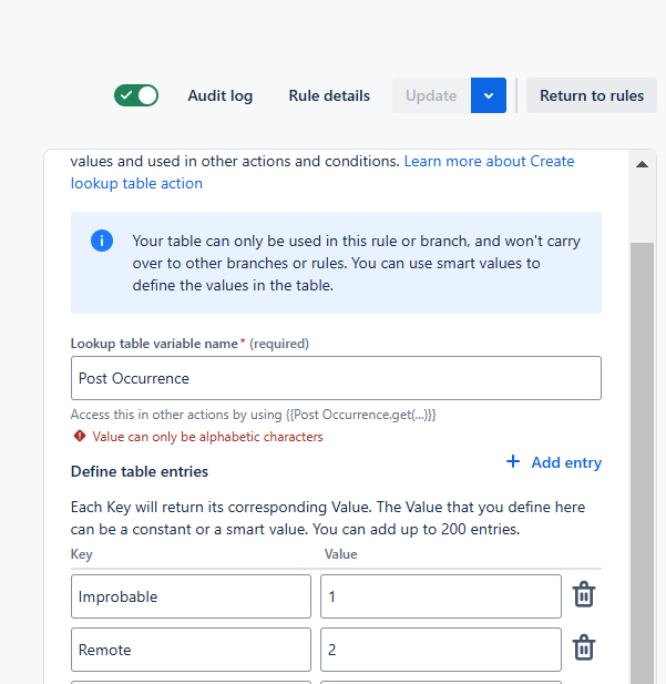

thumuluru.shreya
January 5, 2025
Hi @Bill Sheboy  and @Valerie Knapp . I have doubt in saving name in look up variable. We cannot save look up variable name as Post Occurrence or Occurrence (Post). Because I need to use 2 Occurrences those are Pre Occurrence and Post Occurrence. But I am not able to save in Look up variable. Is there any work around for this?Screenshot (1041).png
Kumar_rajarapu
January 5, 2025
Hi @thumuluru.shreya , Remove Space between the words to save
Like # people like this
thumuluru.shreya
January 5, 2025
@Kumar_rajarapu , Space should be there in my requirement. How to handle this error in look up table?
Marc -Devoteam-
January 6, 2025
You can't as stated by @Kumar_rajarapu and the warning message says it also.
You can only use alphabetic characters, so no spaces or other special signs.

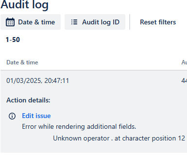

thumuluru.shreya
January 3, 2025
@Kumar_rajarapu I copied same rule but I am getting error. Could you please help in this
