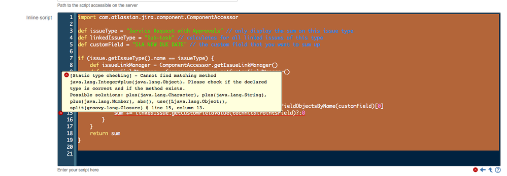

Is anyone else getting an error when trying to use this code? I found it in the Screen Shot 2018-11-20 at 10.56.07 AM (2).png library
import com.atlassian.jira.component.ComponentAccessor
def issueType = "Service Request with Approvals" // only display the sum on this issue type
def linkedIssueType = "Sub-task" // calculates for all linked issues of this type
def customField = "SLA NEW DUE DATE" // the custom field that you want to sum up
if (issue.getIssueType().name == issueType) {
def issueLinkManager = ComponentAccessor.getIssueLinkManager()
def customFieldManager = ComponentAccessor.getCustomFieldManager()
def sum = 0
issueLinkManager.getOutwardLinks(issue.id).each {issueLink ->
def linkedIssue = issueLink.getDestinationObject()
if (linkedIssue.getIssueType().name == linkedIssueType) {
def technicalPointsField = customFieldManager.getCustomFieldObjectsByName(customField)[0]
sum += linkedIssue.getCustomFieldValue(technicalPointsField)?:0
return sum

Mark Markov
November 20, 2018
Hello @Jacob francois
This is static type checking error, you can ignore it. It appears because getCustomFieldValue can return various types of result like ApplicationUser, Integer, Options etc. and compiler doesn't know which one, so error appears.
