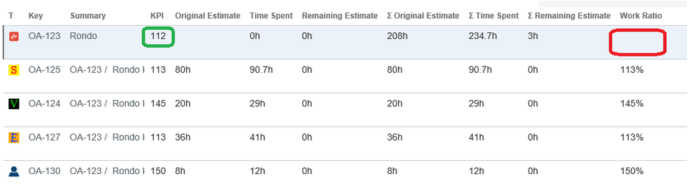

we have a Project with Tasks and Subtasks. The time logging is only done in the Subtasks. The WorkRatio is automatically calculated by JIRA for the Subtasks.
But it is not working for the Tasks (with the sums: E-original Estimate).
So i used the addon "JIRA Misc Custom Fields" with a "Calculated Number Field".
My sum calculation works, but I found that it creates a lot of Errors in the logfile.

Could you explain "The WorkRatio is automatically calculated by JIRA for the Subtasks.  But it is not working for the Tasks" more?
Alexander Pappert
October 11, 2017
I mean the red marked JIRA Field "WorkRatio".
But workratio is only filled for the Subtasks.
Thats why i tried to calculate it manually as KPI, see the green marking.

There is no work ratio for the top-level issue, you already said you don't put estimates on it.

The sum up data are the jira fields:
aggregatetimespent
aggregatetimeoriginalestimate
They are calculated by jira.
The jira workratio is calculated with timespent and originalesimate, not with the "aggreagte" ones.
I edited my script a bit because  it only set null to 0. I forgot that I also had some 0 as values, which I must exclude because Division by 0 is not allowed.
I think that these were my Errors in the logfile.
It works for me now.
