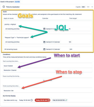

Below is a example of a SLA for time to resolution.

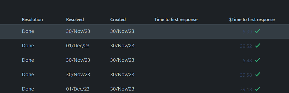

As you can see we have a made-up first response time, and in the reporting its counts based on the calendar and its not show after how many min or hours the agents replied to the ticket.
Im trying to create a field or a solution to see the time duration when the ticket is open and agent replies. (I made a complex reporting when the sla is calculated with the calendar and I can see when the first reply made but that only gives the time inside the calendar and its not collect outside calendar hours. )

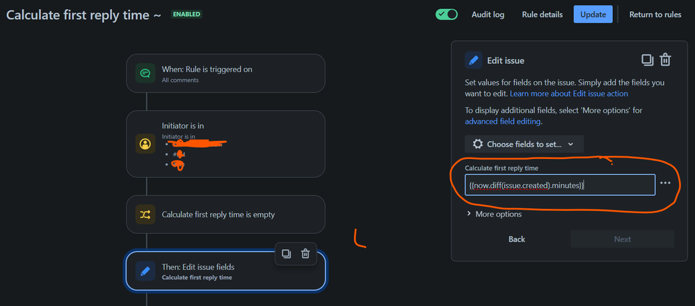

Mkrtich Tono
January 31, 2024
@Manne Kjærby - ProProces  thanks for clarifying this!
I have modified it and its working now!
I will keep the screenshot here so maybe someone else needs it.
The only thing that was not working properly
is that the numbers in the custom fields are showing -
like -5 or -2
