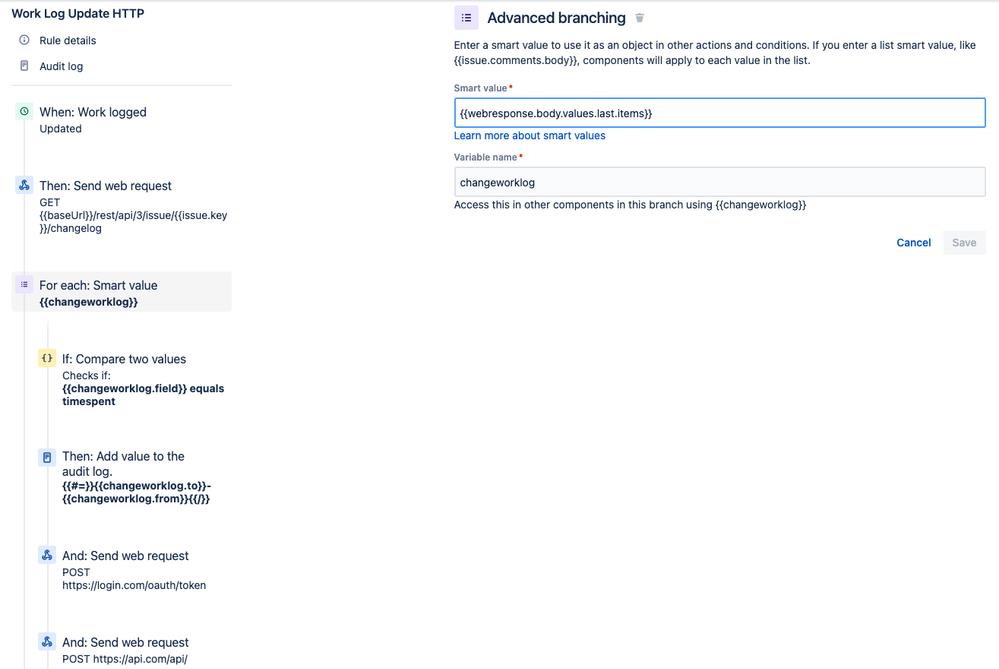

I created separate rules for CREATE, UPDATE and DELETE worklogs. CREATE and DELETE was easy to handle as that just adds or subtracts, the logic for UPDATE was a bit more complex and brittle.
I ended up using the changelog from the API. It relies on the last value in there being the worklog that triggered the automation. This would have been a lot simpler if I had access to the changelog from a worklog triggered action

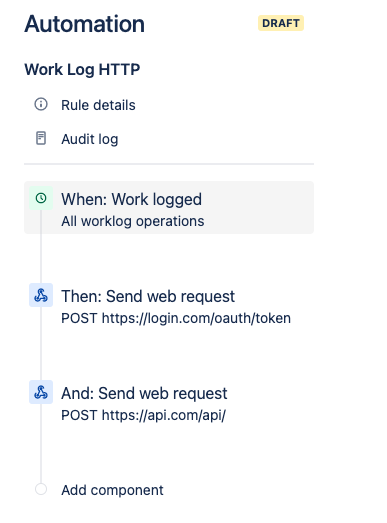

Example automation above. This works fine for sending newly created work logs, however when a user edits them I would like to know the before and after values. Currently I can only access the "after value"

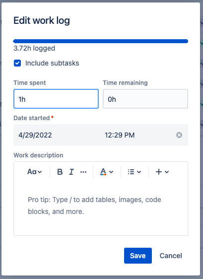

@Stefan Salzl my use case is that I'd like to be able to send the time logged against an issue by each user to a downstream service for timetracking and for that I need to calculate the time logged against that worklog. Create and Delete actions are fine but for updates I'd like to know what the initial value is, I've given a few scenarios below to help illustrate:
User creates a 2h worklog: send 2h to downstream service
User edits that work to be 3h: send 1h to downstream service
User edits that worklog again to be 1h: send -2h to downstream service
User deletes that worklog: send -1h to downstream service
Also, the above solution unfortunately doesnt work as I can't use the time logged against the issue because the rule runs after the worklog has been changed which means the issue has the updated value

WOW!!!! That´s awesome. API was something that came to my mind but I do have too little knowledge of its capability and to really provide you a feasible solution 🙈
Great job man! Your solution looks awesome 🙌 I feel you. I don´t understand either why "worklog" does not appear as "value / field change" and cannot be covered by trigger action as such =S
