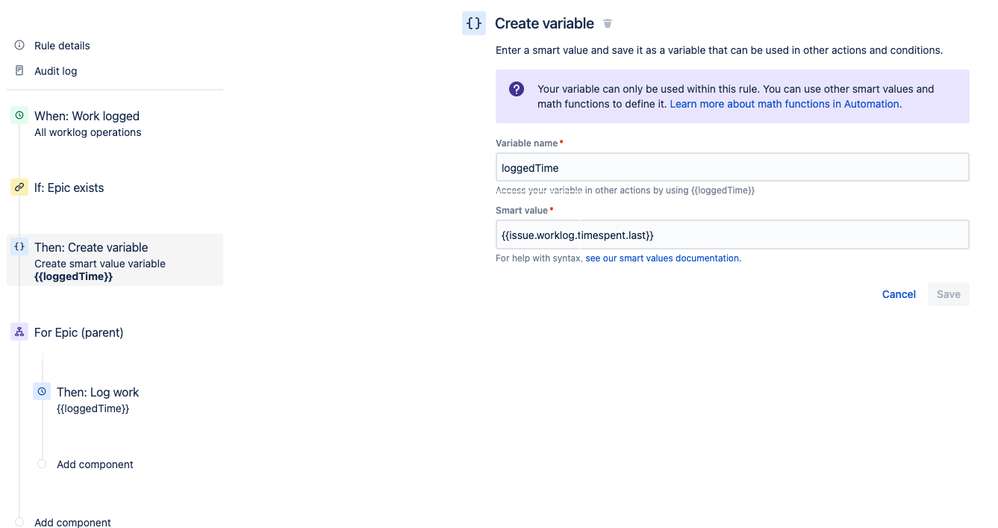

Posting what I came up with to solve our use case (using only native functionalities + Automation for Jira), it might be useful for someone with a similar use case 🤞
The variable is not strictly needed to achieve this, but I'll have to expand the automation so I've left it there.
Mrudula.Madugu
October 5, 2022
Hi
Thanks for the above rule, but this rule is not working when timelogged for subtask in the stories, Epic timelog is not updating. Do you have any suggestion here?

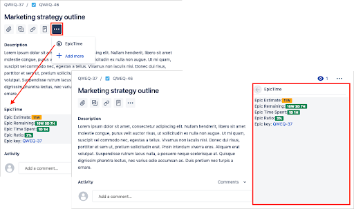

Hi @Giulia Caberlotto
I've noticed you are looking for a solution that doesn't need any expenses. Maybe you will be interested in out app Teamlead: EpicTime for Jira - SumUp of Worklogs.
It's free for teams that are up to ten users.
EpicTime sums up work logs of child issues to the epic. Also, you can view the following information within Epic's issues:
  • Epic Estimate
  • Epic Time Spent
  • Epic Remaining
  • Epic Ratio (percentage of the spent time)

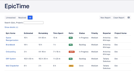

A variety of reports provides data about time results for all epic issues.

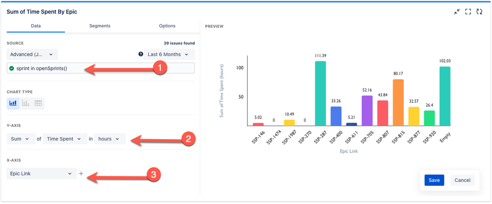

Hi @Giulia Caberlotto ,
You can try Reports - Charts and Graphs for Jira app developed by our team to create various reports, charts and graphs for your Jira projects.
Here is a sample report that shows sum of time spent by epic.
  1. You first define your data source, it can be projects or custom JQL you type.
  2. Set Y-Axis, in your case Sum of Time Spent in hours
  3. Set X-Axis, in your case Epic.
Below you can see an article about creating custom reports, charts and graphs in Jira with our app.
How to Create Custom and Flexible Reports, Charts and Graphs in Jira
Here is our live demo dashboard where you can see and modify sample reports and play with them.
Hope it helps.
