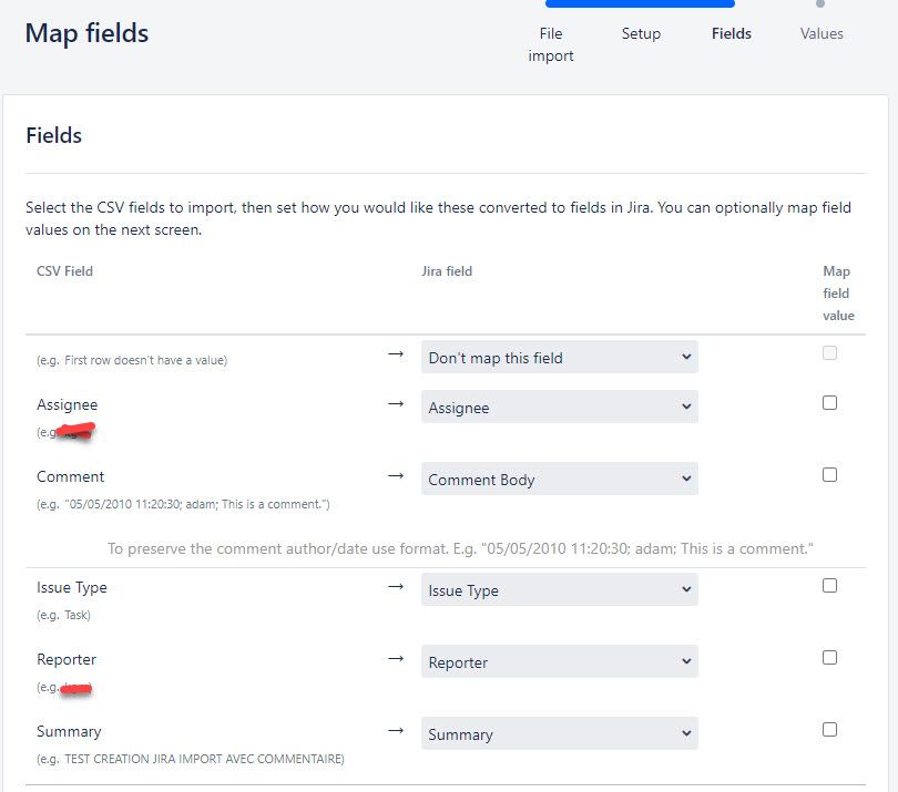

Hi @Thibault_O_
It works fine for me without a configuration file when I used the "External System Import" under the System menu in the Admin. My comment was like this:
"05/05/2010 11:20:30; adam; This is a comment."
Mapping:
HTH,
KGM
Thibault_O_
December 9, 2021
Hi @Kristján Geir Mathiesen ,
This screenshot made me realize that I am not mapping to the correct field.
As I do not have access to "External System Import" under the System menu in the Admin, I do not have access to this data in the mapping.
So I will first see with an administrator to map with this field.
Probably after this change it will work.
Thank you for the answer.

Thibault_O_
December 9, 2021
Hi @Alexis Robert ,
I just tried without the configuration file and I have the same error.
Thanks to @Kristján Geir Mathiesen's screenshot , I think I know where the problem comes from: I am not mapping to the right field. Indeed, on its screenshot, @Kristján Geir Mathiesen  is mapping on the "Comment body" field while I am mapping on the "Comment" field.
Thank you for answering.
