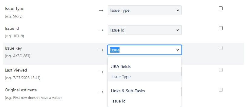

I have a company-wide project where I created a few test issues through GUI - I am trying to update these by exporting them to ExcelCSV format, making changes and then importing them back to Jira. All my different attempts are resulting in creation of new issues instead of existing issues being updated. The issue repros even with a newly created item.

Any inputs on what could be going wrong here?

Thanks for the reply - as shown above - I am not seeing Issue Key in the dropdown box - not sure what's going on - any ideas?

Looks like .csv file does not have issuekey. Is this file exported from another Jira instance ?

No, it is from the same Jira instance. The csv file does have the issue key. As you can see the screenshot above, the source does have it. I tried creating a brand-new project and I see the same behavior (Gui does not give the option to select Issue Key mapping during export). I will try this with a different project in a different Jira instance later today and see what happens.

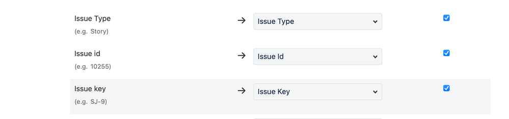

Issue Key will be shown through Admin System import. That's another import module only for admins.

Hi All, after trying different things and going through articles, I found a work around for this.
- Go to "System" from the wheel icon option on the right side top corner.
- Open "External System Import"
- Switch to the old Experience (this is very important step for me to see the Issue Key)
- Select CSV option and proceed.
FYI @Teresa Douglas
Atleast for me, I could not find the "Issue Key" drop-down until I changed to old Experience. Hope this helps!

Hello, While importing the .csv file to update the fields you need to make sure to map Issuekey, issuetype field.

Thanks for the reply - as shown in the screenshot below- I am not seeing Issue Key in the dropdown box - not sure what's going on - any ideas?
