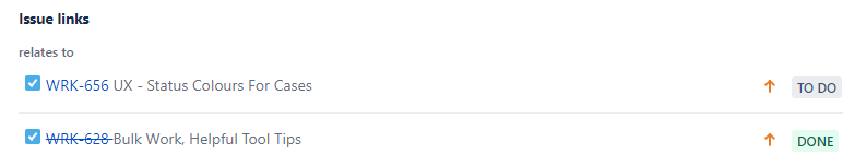

Example of the Issue Links
Can anybody please provide some assistance?

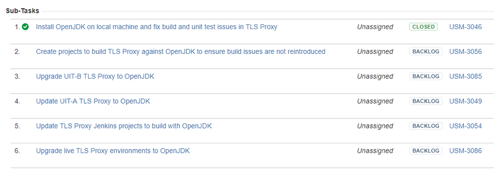

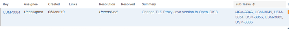

I have attached a copy of the Jira and Sub-Taks and also a copy of my CSV import file.
Thanks
Shaun

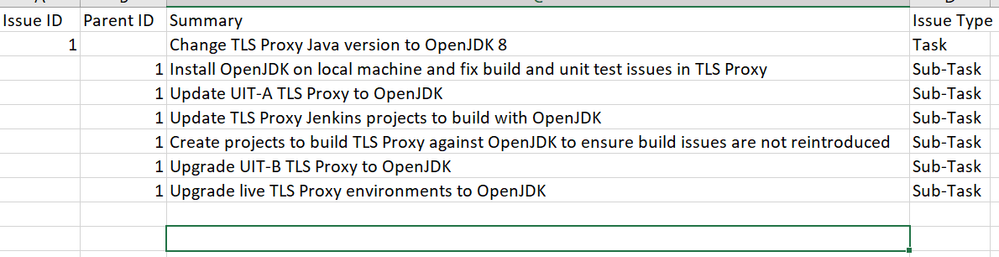

My CSV Import File.

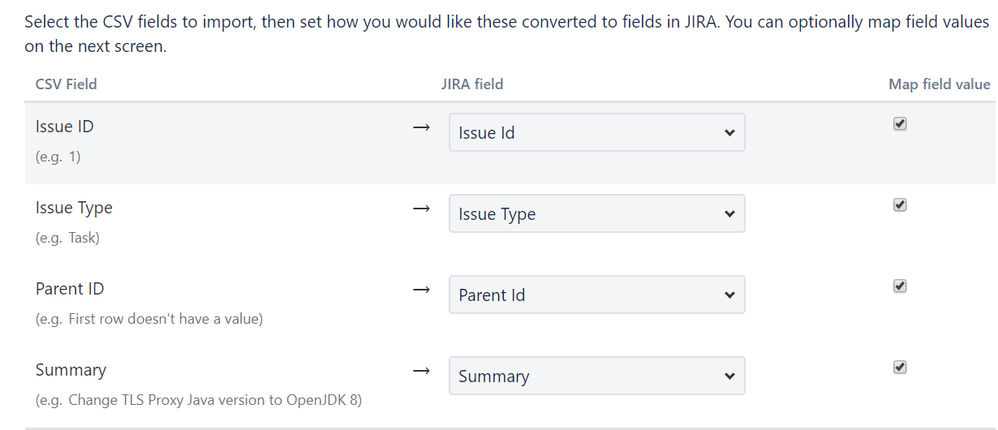

And this is the action I am doing on the import
Shaun Parker

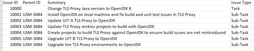

I am not having much luck, this is another scenario I have tried.
