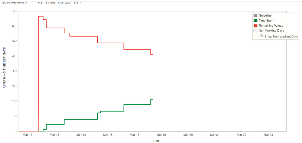

It looks like that because the sprint was started without any issues assigned to the sprint. Issues where added after the start and that is why you see the spike at the beginning, and it is also why you do not see the guideline.

The sprint was started before the issues. Thanks, now the guideline is shown

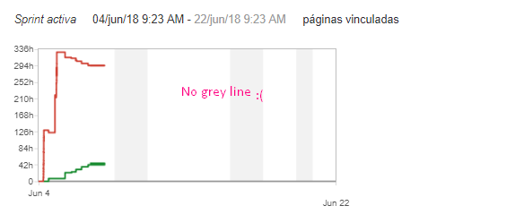

Have a similar behaviour... Thanks for the answer....
One question more ....
Why I haven´t I got the grey line to compare with my Team velocity? I had it on previous Sprints...

@Mauricio Ferreyra If you look at the chart for your current sprint, you have a gap from when the sprint was started until you added issues to the sprint, and that is why you do not have the guideline. Same issue as above.
In order to see the guideline you have to add issues to the sprint before it is started.

Strange @Mikael Sandberg, because some issues (not all) were added before sprint was started.

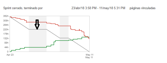

The problem I had was that some histories were differed from previous Sprint
Is it any turnaround to bring back my sprint guideline?

Did the issues you had on the sprint have estimates on them? The guideline is based on the sum of estimates, so you have to make sure all issues are estimated.
The only way to bring the guideline back is to start a new sprint.
