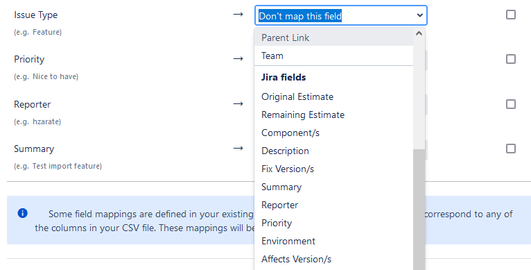

Héctor Z.
December 2, 2021
Hi,
I have the same problem. In the screen to do the mapping, the list to select to what to map in Jira there is no way to select the Issue Type. See:

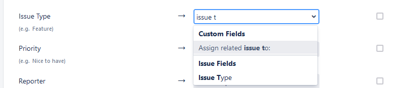

Héctor Z.
December 2, 2021
Hi Eleni,
You are right. I just tried to do it from the Admin panel, and then I can select it:
