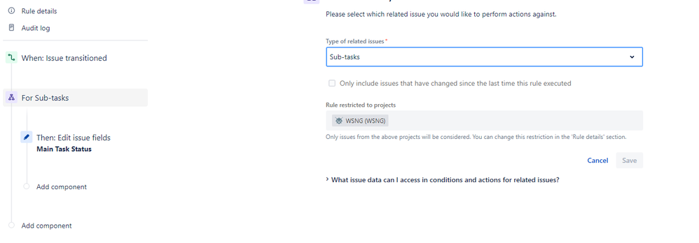

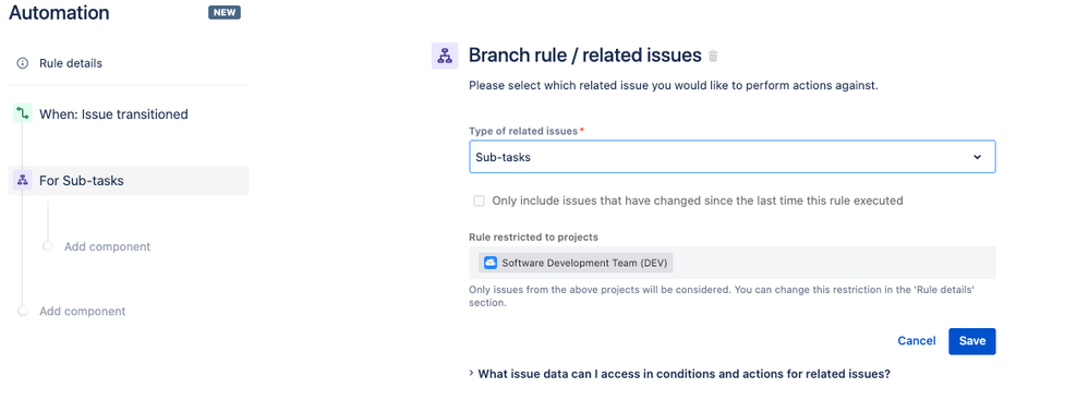

Can you show us the rule you have set up?
You should be able to affect all the sub-tasks that are associated to the issue at the time the rule runs, regardless of when the sub-task was created, using the Branch/Related Issues option.
