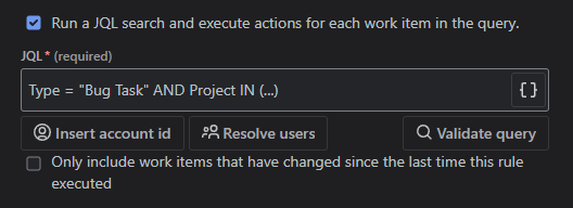

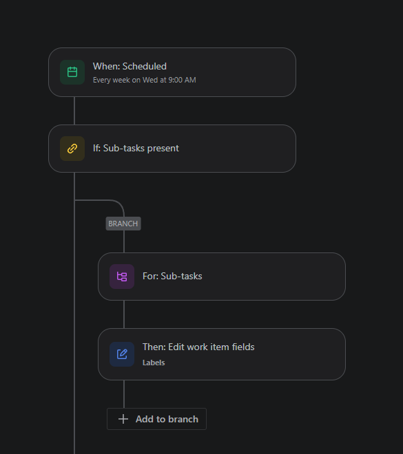

I would suggest configuring an automation rule with a scheduled trigger and a query to narrow the scope as much as possible. Here you would want to identify the parent work items and if possible within the scope of projects that the sub-tasks reside in.
Then configure the rule to iterate through the sub-tasks for each of the parent items and set a label to differentiate the work type you want to move them to (ie Bug Task).
You should then be able to repeat the same steps as in 3. and 4. to do a bulk move and work type change. If needed, you can even remove the label at the time of move.
Be mindful that the JQL query in the automation rule against the parent work items should return 1000 items or less or the rule will throttle. A few automation runs, and 4 bulk moves should finish this out for you. Let me know if you need any further clarification. Hopefully this helps solve your problem!
