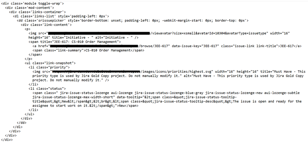

Poojaa Sudhakaran
March 31, 2020
Thanks Egor.
I've tried your approach and I got html code snippet as shown below.
<div class='module toggle-wrap'> <div class='mod-content'> <div class='links-container'> <dl class='links-list' style='padding-left: 0px'> <dd class='srissuepicker' s..
I'm not able to view the complete snippet. Kindly help me in resolving this.
Thanks,
Poojaa
Egor Tasa [ALM Works]
March 31, 2020
Ok, let's try the following, Poojaa,
Add a column to your structure with the same approach: Formula>field_name>Manual specification, change to html. In formula column, you should be able to see the full snippet (click on vertical ... to see the full text).
Regards,
Egor
Poojaa Sudhakaran
March 31, 2020
Thanks Egor, please find the screenshot below.
