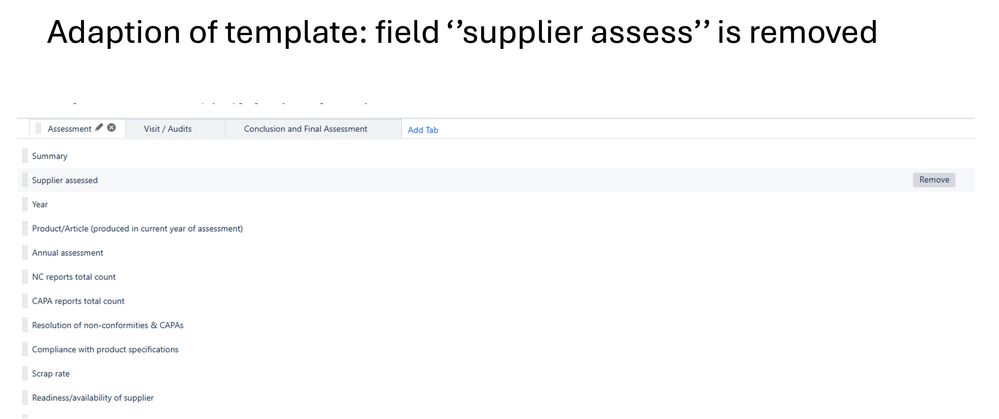

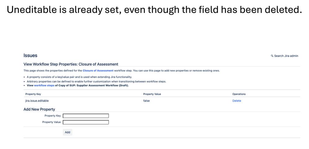

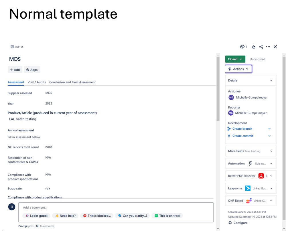

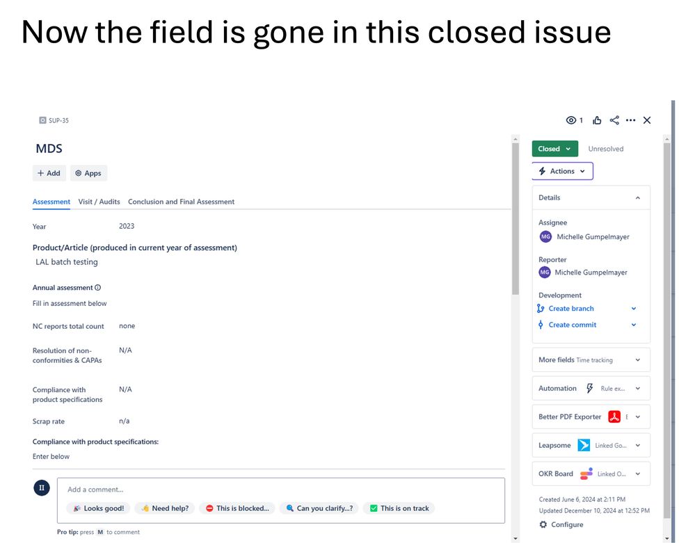

I actually I do not want that the fields are removed from the closed issues. But this is what Jira is doing. When removing a custom field today the field also gets removed in a closed issue from year 2021. Leading to lost data from a cosed issue.
Lots of users are not aware of this ''bug'' in Jira and Atlassian support mentioned that this is not how Jira should behave, but it does for multiple users.
Do you experience the same?
Please find also attached some images of my experiment, where I removed the custom field ''supplier assessed''.
Please see also here the open ticket: https://jira.atlassian.com/browse/JRACLOUD-92148

The field and its data don't disappear; they simply become hidden. You can still view all fields and values in the issue navigator, for example. However, if you remove the project context of the field, the data will be permanently deleted for that project.
