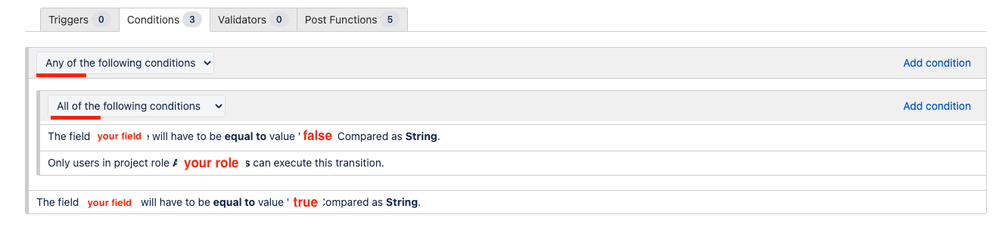

If so then your workflow transition conditions would look like this:

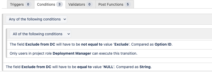

Below is how I have the settings

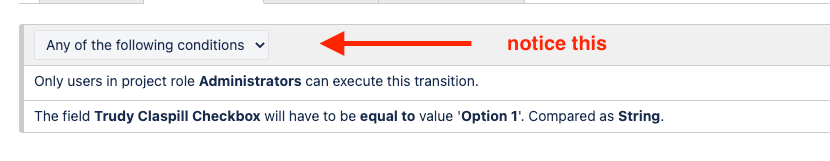

I think I overcomplicated it.
I think that this will work for you, but I recommend that you try it in a test project first.
Substitute values accordingly
Trudy Claspill Checkbox >> Exclude from DC
Administrators >> Deployment Manager
Option 1 >> Exclude
This should work such that
- anybody can transition the issue if Exclude from DC is set to Exclude
- users in the Deployment Manager role can transition the issue always.
