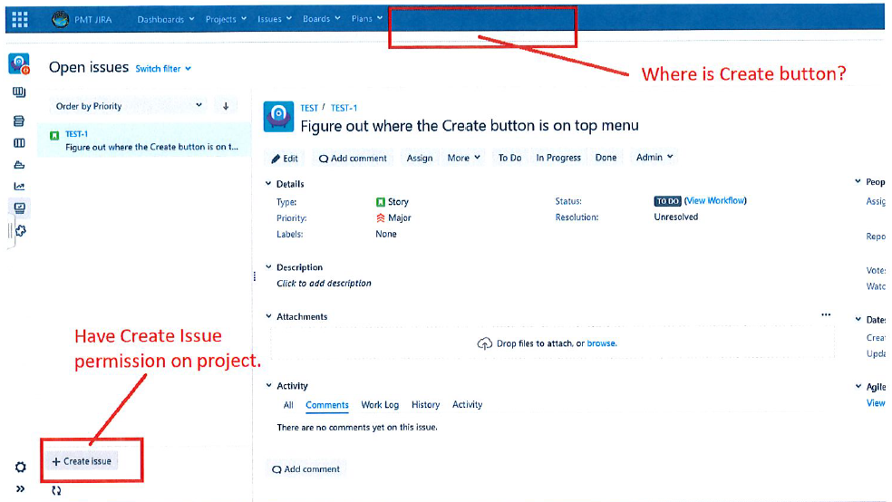

I see no way to create a support case in the link you provided. I can only ask the Community a question, which I have posted with no response.  To be clear, here is the latest information after we installed a 30-day trial license.  We have the Boards back, but still no Create button, although we can get to the screen when typing in the URL and we can create issues using the + option.  See below.  Can you provide info on how I submit a support ticket?
We are currently using a 30-day trial license of Jira version 8.17.1.  We upgraded from an older version, and have disabled all user-installed plug-ins.  I am a System Admin and I have made sure I have permission to Create Issues on projects.  I can do so using the + Create issue button on the bottom-left of the screen from within a project.  However, in a previous Jira version, we had a Create button in the menu bar at the top of the screen.  This button no longer displays.  If we type the URL https://[IP]/secure/CreateIssue!default.jspa we can get to the screen that the button display.  But we don’t see the button!!  How do I get it back?  There are no errors in the log indicating an issue that would prevent this button from displaying. no_create.PNG

Andy, first off, thank you so much for your time on this and your request to allow SEN numbers for your support tickets.  We have finally uncovered the issue causing the Create button not to display.   There was a disabled component in the "Atlassian Jira - Plugins - Header Plugin" called webfragments.navigation.bar.issues.item.new.issues
 Re-enabling and refreshing brought the button back.
