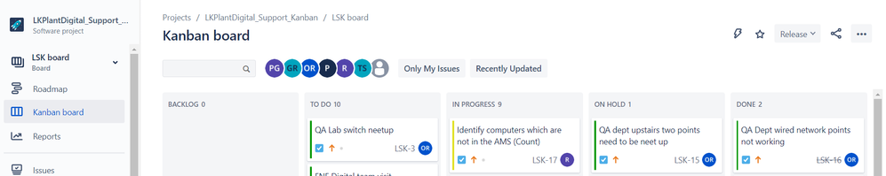

Pramodya Gamaethige
July 9, 2021
Hi @Fazila Ashraf i have changed the workflow as shown in the picture and project leader can see the board. Other members cant see the board. Appreciate if you could help. Thankskanban.PNG
