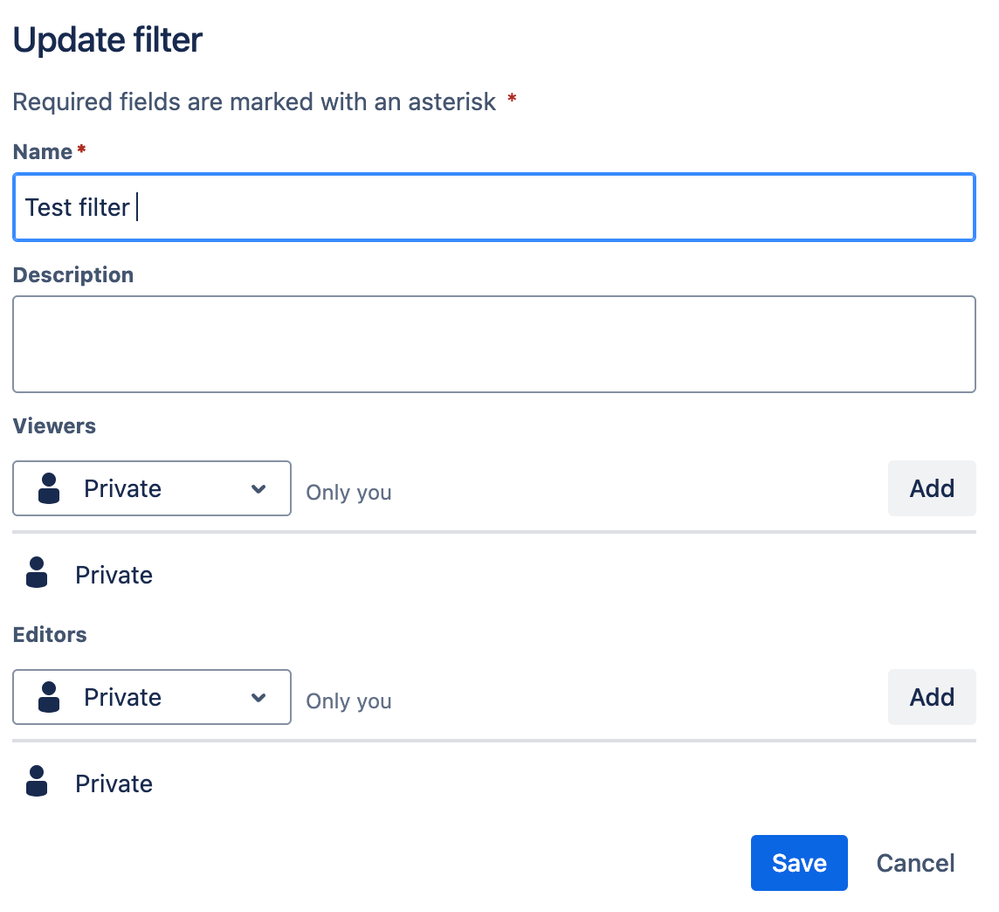

Hey @Gonzalo Diaz - Can you please check on the filter and find out the permissions of that particular filter.
Filter >> filter details >> Edit permissions
If the filter is private users might not be able to see the issues on that board with a particular filter.

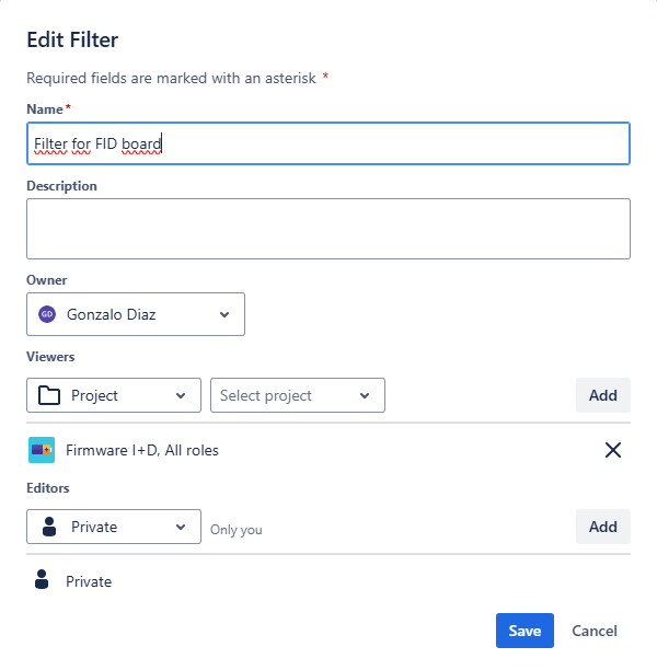

Hi Bharat.
It is like this

@Gonzalo Diaz  where is the board located? Is it under the same project? " Firmware I+D"... you can also try adding one of the user explicitly in the viewers to find out if it is actually a permissions issue and see if the user can see it.

I just tried that and the same thing is still happening.
To give more information, I log in with my colleague's username and in the list view, all the incidents are seen, but nothing is seen on the board.
