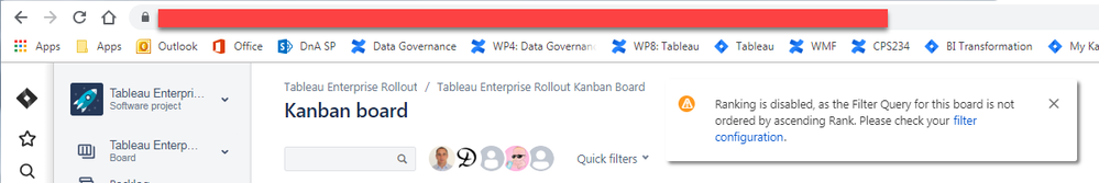

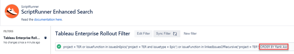

I created a query filter using Adaptavist ScriptRunner Enhanced Search plug-in and then based a Board on this filter.

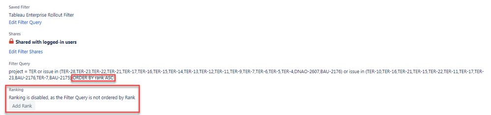

The query includes "ORDER BY Rank ASC" clause but I keep getting warnings that Ranking is Disabled in the board.
When I click "Add Rank" the query does not change. Seems like a plug-in integration / sync issue.

I think this is a known issue ? Remove the "ASC" ?
Leroy
February 13, 2019
Thanks Marc. I had seen the question but not the answer. I thought I had tried that before but I tried it again on a simpler script and it worked!
