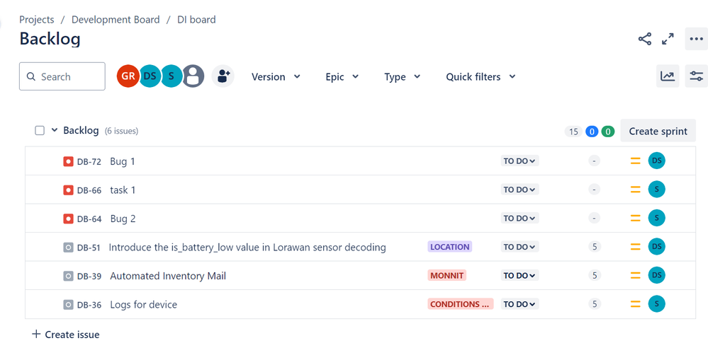

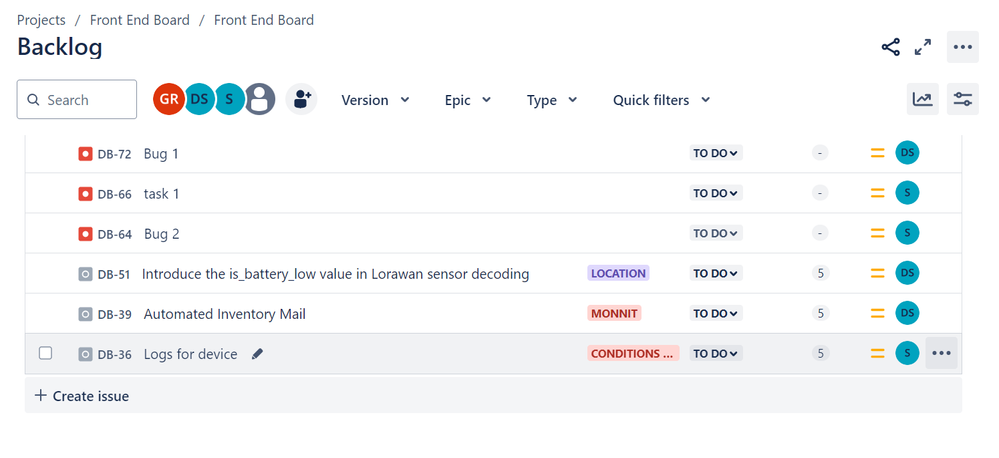

This is the main board. I have created a filter project = "Development Board" and assignee in membersOf("Front End") and made a board based on that as you can see below

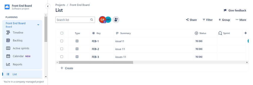

Now both the boards are displaying the same product backlog because of that filter. Now, when I am creating issues separately on Front End Board, I dont see them on backlog list but see it under LIST column on the left.
Now, what to do so that the issues made on Front End Board is directly seen on PB and not under list.

The assignee field for new issue is from the front end team only.
My question is whenever we create issues normally it appears in the backlog but why is it going to list here?
Front End Board is created with the filter from the main board.
The status of new issues are all in TO DO.
New issues are created in the Front End board and they are not reflecting on Main Board. Only the issues that is created and assigned to members of front end team is shown in Front End Board.

Development Board is the Main Board for us. I have created filter project = "Development Board" and assignee in membersOf("Front End")  and I have made a separate scrum board using the same filter. This is because the front end lead can separately view what the front end team is doing without any hassle.
So, whatever issues are raised on the Development Board and having assignees from front end group will display on the Front End Board as well.
But, my question is whenever I now go to Front End Board and try creating issues there in the backlog. The issues do not appear on the backlog page itself but is appearing on the LIST. Now, what must be done so that the issues created on the Front End Board is appearing directly on the backlog page.
