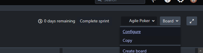

We have an issue accessing the board configuration. When I click the "configure" option below, the configuration page was blank.

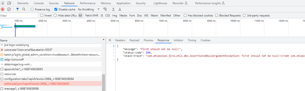

I tried to look up the endpoint of /rest/greenhopper/1.0/rapidviewconfig/editmodel.json as suggested here (Section of Diagnosis for Root Cause 4), and I got this "First should not be null" error in response.
It is not clear to me as to what "First" means and what are the suggested steps to debug this error. Could you provide any advice, please?

Yes of course. This is entire json
{"message":"first should not be null!",
"status-code":500,
"stack-trace":"com.atlassian.jira.util.dbc.Assertions$NullArgumentException: first should not be null!\n\tat com.atlassian.jira.util.dbc.Assertions.notNull(Assertions.java:25)\n\tat com.atlassian.jira.util.lang.Pair.strictPairOf(Pair.java:48)\n\tat com.atlassian.jira.util.lang.Pair.of(Pair.java:35)\n\tat com.atlassian.jira.issue.managers.DefaultIssueManager.getProjectIssueTypePairs(DefaultIssueManager.java:834)\n\tat com.atlassian.jira.issue.managers.DefaultIssueManager.getProjectIssueTypePairsByIds(DefaultIssueManager.java:878)\n\tat com.atlassian.jira.issue.managers.RequestCachingIssueManager.getProjectIssueTypePairsByIds(RequestCachingIssueManager.java:335)\n\tat com.atlassian.jira.jql.util.JqlIssueSupportImpl.getProjectIssueTypePairsByIds(JqlIssueSupportImpl.java:91)\n\tat com.atlassian.jira.jql.context.IssueIdClauseContextFactory.getProjectIssueTypesBatch(IssueIdClauseContextFactory.java:74)\n\tat com.atlassian.jira.jql.context.IssueIdClauseContextFactory.getClauseContext(IssueIdClauseContextFactory.java:101)\n\tat com.atlassian.jira.jql.context.MultiClauseDecoratorContextFactory.getClauseContext(MultiClauseDecoratorContextFactory.java:75)\n\tat com.atlassian.jira.jql.context.ValidatingDecoratorContextFactory.getClauseContext(ValidatingDecoratorContextFactory.java:29)\n\tat com.atlassian.jira.jql.context.QueryContextVisitor.visit(QueryContextVisitor.java:121)\n\tat com.atlassian.jira.jql.context.QueryContextVisitor.visit(QueryContextVisitor.java:36)\n\tat com.atlassian.query.clause.TerminalClauseImpl.accept(TerminalClauseImpl.java:143)\n\tat com.atlassian.jira.jql.context.QueryContextVisitor.visit(QueryContextVisitor.java:75)\n\tat com.atlassian.jira.jql.context.QueryContextVisitor.visit(QueryContextVisitor.java:36)\n\tat com.atlassian.query.clause.AndClause.accept(AndClause.java:28)\n\tat com.atlassian.jira.jql.context.QueryContextVisitor.visit(QueryContextVisitor.java:99)\n\tat com.atlassian.jira.jql.context.QueryContextVisitor.visit(QueryContextVisitor.java:36)\n\tat com.atlassian.query.clause.OrClause.accept(OrClause.java:28)\n\tat com.atlassian.jira.jql.context.QueryContextVisitor.createContext(QueryContextVisitor.java:54)\n\tat com.atlassian.jira.jql.context.QueryContextVisitor.visit(QueryContextVisitor.java:93)\n\tat com.atlassian.jira.jql.context.QueryContextVisitor.visit(QueryContextVisitor.java:36)\n\tat com.atlassian.query.clause.OrClause.accept(OrClause.java:28)\n\tat com.atlassian.jira.bc.issue.search.DefaultSearchService.getQueryContext(DefaultSearchService.java:219)\n\tat sun.reflect.GeneratedMethodAccessor1985.invoke(Unknown Source)\n\tat sun.reflect.DelegatingMethodAccessorImpl.invoke(DelegatingMethodAccessorImpl.java:43)\n\tat java.lang.reflect.Method.invoke(Method.java:498)\n\tat com.atlassian.plugin.util.ContextClassLoaderSettingInvocationHandler.invoke(ContextClassLoaderSettingInvocationHandler.java:26)\n\tat com.sun.proxy.$Proxy499.getQueryContext(Unknown Source)\n\tat sun.reflect.GeneratedMethodAccessor1985.invoke(Unknown Source)\n\tat sun.reflect.DelegatingMethodAccessorImpl.invoke(DelegatingMethodAccessorImpl.java:43)\n\tat java.lang.reflect.Method.invoke(Method.java:498)\n\tat com.atlassian.plugin.osgi.bridge.external.HostComponentFactoryBean$DynamicServiceInvocationHandler.invoke(HostComponentFactoryBean.java:130)\n\tat com.sun.proxy.$Proxy499.getQueryContext(Unknown Source)\n\tat com.atlassian.greenhopper.service.workflow.SimplifiedWorkflowServiceImpl.getPotentialWorkflowForConversion(SimplifiedWorkflowServiceImpl.java:185)\n\tat com.atlassian.greenhopper.service.workflow.SimplifiedWorkflowServiceImpl.getGreenHopperSimplifiedWorkflow(SimplifiedWorkflowServiceImpl.java:137)\n\tat com.atlassian.greenhopper.web.rapid.workflow.WorkflowHelper.getGreenHopperSimplifiedWorkflow(WorkflowHelper.java:79)\n\tat com.atlassian.greenhopper.web.rapid.workflow.WorkflowHelper.isRapidViewUsingGreenHopperSimplifiedWorkflow(WorkflowHelper.java:55)\n\tat com.atlassian.greenhopper.web.rapid.view.ColumnEditHelper.buildSimplifiedWorkflowEntry(ColumnEditHelper.java:205)\n\tat com.atlassian.greenhopper.web.rapid.view.ColumnEditHelper.buildColumnEditModel(ColumnEditHelper.java:177)\n\tat com.atlassian.greenhopper.web.rapid.view.RapidViewEditHelper.getEditModel(RapidViewEditHelper.java:181)\n\tat com.atlassian.greenhopper.web.rapid.view.RapidViewEditResource$9.call(RapidViewEditResource.java:221)\n\tat com.atlassian.greenhopper.web.rapid.view.RapidViewEditResource$9.call(RapidViewEditResource.java:215)\n\tat com.atlassian.greenhopper.web.util.RestCall.response(RestCall.java:38)\n\tat com.atlassian.greenhopper.web.AbstractResource.createResponse(AbstractResource.java:87)\n\tat com.atlassian.greenhopper.web.AbstractResource.response(AbstractResource.java:69)\n\tat com.atlassian.greenhopper.web.rapid.view.RapidViewEditResource.getEditModel(RapidViewEditResource.java:215)\n\tat sun.reflect.GeneratedMethodAccessor4618.invoke(Unknown Source)\n\tat sun.reflect.DelegatingMethodAccessorImpl.invoke(DelegatingMethodAccessorImpl.java:43)\n\tat java.lang.reflect.Method.invoke(Method.java:498)\n\tat com.atlassian.plugins.rest.common.interceptor.impl.DispatchProviderHelper$ResponseOutInvoker.lambda$_dispatch$0(DispatchProviderHelper.java:181)\n\tat com.atlassian.plugins.rest.common.interceptor.impl.DispatchProviderHelper.lambda$invokeMethodWithInterceptors$0(DispatchProviderHelper.java:81)\n\tat com.atlassian.plugins.rest.common.interceptor.impl.DefaultMethodInvocation.invoke(DefaultMethodInvocation.java:53)\n\tat com.atlassian.plugins.rest.common.expand.interceptor.ExpandInterceptor.intercept(ExpandInterceptor.java:42)\n\tat com.atlassian.plugins.rest.common.interceptor.impl.DefaultMethodInvocation.invoke(DefaultMethodInvocation.java:53)\n\tat com.atlassian.plugins.rest.common.interceptor.impl.DispatchProviderHelper.invokeMethodWithInterceptors(DispatchProviderHelper.java:106)\n\tat com.atlassian.plugins.rest.common.interceptor.impl.DispatchProviderHelper$ResponseOutInvoker._dispatch(DispatchProviderHelper.java:180)\n\tat com.sun.jersey.server.impl.model.method.dispatch.ResourceJavaMethodDispatcher.dispatch(ResourceJavaMethodDispatcher.java:75)\n\tat com.sun.jersey.server.impl.uri.rules.HttpMethodRule.accept(HttpMethodRule.java:302)\n\tat com.sun.jersey.server.impl.uri.rules.RightHandPathRule.accept(RightHandPathRule.java:147)\n\tat com.sun.jersey.server.impl.uri.rules.ResourceClassRule.accept(ResourceClassRule.java:108)\n\tat com.sun.jersey.server.impl.uri.rules.RightHandPathRule.accept(RightHandPathRule.java:147)\n\tat com.sun.jersey.server.impl.uri.rules.RootResourceClassesRule.accept(RootResourceClassesRule.java:84)\n\tat com.sun.jersey.server.impl.application.WebApplicationImpl._handleRequest(WebApplicationImpl.java:1542)\n\tat com.sun.jersey.server.impl.application.WebApplicationImpl._handleRequest(WebApplicationImpl.java:1473)\n\tat com.sun.jersey.server.impl.application.WebApplicationImpl.handleRequest(WebApplicationImpl.java:1419)\n\tat com.sun.jersey.server.impl.application.WebApplicationImpl.handleRequest(WebApplicationImpl.java:1409)\n\tat com.sun.jersey.spi.container.servlet.WebComponent.service(WebComponent.java:409)\n\tat com.sun.jersey.spi.container.servlet.ServletContainer.service(ServletContainer.java:558)\n\tat com.atlassian.plugins.rest.module.RestDelegatingServletFilter$JerseyOsgiServletContainer.doFilter(RestDelegatingServletFilter.java:160)\n\tat com.sun.jersey.spi.container.servlet.ServletContainer.doFilter(ServletContainer.java:829)\n\tat com.atlassian.plugins.rest.module.RestDelegatingServletFilter.doFilter(RestDelegatingServletFilter.java:70)\n\tat com.atlassian.plugin.servlet.filter.DelegatingPluginFilter.doFilter(DelegatingPluginFilter.java:62)\n\tat com.atlassian.plugin.servlet.filter.IteratingFilterChain.doFilter(IteratingFilterChain.java:37)\n\tat com.atlassian.plugin.servlet.filter.ServletFilterModuleContainerFilter.doFilter(ServletFilterModuleContainerFilter.java:56)\n\tat com.atlassian.plugin.servlet.filter.ServletFilterModuleContainerFilter.doFilter(ServletFilterModuleContainerFilter.java:44)\n\tat com.atlassian.plugin.servlet.filter.DelegatingPluginFilter.doFilter(DelegatingPluginFilter.java:62)\n\tat com.atlassian.plugin.servlet.filter.IteratingFilterChain.doFilter(IteratingFilterChain.java:37)\n\tat com.atlassian.plugin.servlet.filter.DelegatingPluginFilter.lambda$doFilter$0(DelegatingPluginFilter.java:57)\n\tat com.atlassian.plugins.rest.module.servlet.RestServletUtilsUpdaterFilter.doFilterInternal(RestServletUtilsUpdaterFilter.java:23)\n\tat com.atlassian.plugins.rest.module.servlet.RestServletUtilsUpdaterFilter.doFilter(RestServletUtilsUpdaterFilter.java:35)\n\tat com.atlassian.plugin.servlet.filter.DelegatingPluginFilter.doFilter(DelegatingPluginFilter.java:62)\n\tat com.atlassian.plugin.servlet.filter.IteratingFilterChain.doFilter(IteratingFilterChain.java:37)\n\tat com.atlassian.plugin.servlet.filter.DelegatingPluginFilter.lambda$doFilter$0(DelegatingPluginFilter.java:57)\n\tat com.atlassian.applinks.core.rest.context.ContextFilter.doFilter(ContextFilter.java:24)\n\tat com.atlassian.plugin.servlet.filter.DelegatingPluginFilter.doFilter(DelegatingPluginFilter.java:62)\n\tat com.atlassian.plugin.servlet.filter.IteratingFilterChain.doFilter(IteratingFilterChain.java:37)\n\tat com.atlassian.plugin.servlet.filter.DelegatingPluginFilter.lambda$doFilter$0(DelegatingPluginFilter.java:57)\n\tat com.atlassian.applinks.core.rest.context.ContextFilter.doFilter(ContextFilter.java:24)\n\tat com.atlassian.plugin.servlet.filter.DelegatingPluginFilter.doFilter(DelegatingPluginFilter.java:62)\n\tat com.atlassian.plugin.servlet.filter.IteratingFilterChain.doFilter(IteratingFilterChain.java:37)\n\tat com.atlassian.plugin.servlet.filter.DelegatingPluginFilter.lambda$doFilter$0(DelegatingPluginFilter.java:57)\n\tat com.atlassian.applinks.core.rest.context.ContextFilter.doFilter(ContextFilter.java:24)\n\tat com.atlassian.plugin.servlet.filter.DelegatingPluginFilter.doFilter(DelegatingPluginFilter.java:62)\n\tat com.atlassian.plugin.servlet.filter.IteratingFilterChain.doFilter(IteratingFilterChain.java:37)\n\tat com.atlassian.plugin.servlet.filter.DelegatingPluginFilter.lambda$doFilter$0(DelegatingPluginFilter.java:57)\n\tat com.atlassian.applinks.core.rest.context.ContextFilter.doFilter(ContextFilter.java:24)\n\tat com.atlassian.plugin.servlet.filter.DelegatingPluginFilter.doFilter(DelegatingPluginFilter.java:62)\n\tat com.atlassian.plugin.servlet.filter.IteratingFilterChain.doFilter(IteratingFilterChain.java:37)\n\tat com.atlassian.plugin.servlet.filter.DelegatingPluginFilter.lambda$doFilter$0(DelegatingPluginFilter.java:57)\n\tat com.atlassian.applinks.core.rest.context.ContextFilter.doFilter(ContextFilter.java:24)\n\tat com.atlassian.plugin.servlet.filter.DelegatingPluginFilter.doFilter(DelegatingPluginFilter.java:62)\n\tat com.atlassian.plugin.servlet.filter.IteratingFilterChain.doFilter(IteratingFilterChain.java:37)\n\tat com.atlassian.plugin.servlet.filter.DelegatingPluginFilter.lambda$doFilter$0(DelegatingPluginFilter.java:57)\n\tat com.atlassian.mywork.client.filter.ServingRequestsFilter.doFilter(ServingRequestsFilter.java:32)\n\tat com.atlassian.plugin.servlet.filter.DelegatingPluginFilter.doFilter(DelegatingPluginFilter.java:62)\n\tat com.atlassian.plugin.servlet.filter.IteratingFilterChain.doFilter(IteratingFilterChain.java:37)\n\tat com.atlassian.plugin.servlet.filter.DelegatingPluginFilter.lambda$doFilter$0(DelegatingPluginFilter.java:57)\n\tat com.atlassian.jira.plugin.mobile.web.filter.MobileAppRequestFilter.doFilter(MobileAppRequestFilter.java:59)\n\tat com.atlassian.core.filters.AbstractHttpFilter.doFilter(AbstractHttpFilter.java:32)\n\tat com.atlassian.plugin.servlet.filter.DelegatingPluginFilter.doFilter(DelegatingPluginFilter.java:62)\n\tat com.atlassian.plugin.servlet.filter.IteratingFilterChain.doFilter(IteratingFilterChain.java:37)\n\tat com.atlassian.plugin.servlet.filter.DelegatingPluginFilter.lambda$doFilter$0(DelegatingPluginFilter.java:57)\n\tat com.atlassian.jira.plugin.mobile.login.MobileLoginSuccessFilter.doFilter(MobileLoginSuccessFilter.java:54)\n\tat com.atlassian.plugin.servlet.filter.DelegatingPluginFilter.doFilter(DelegatingPluginFilter.java:62)\n\tat com.atlassian.plugin.servlet.filter.IteratingFilterChain.doFilter(IteratingFilterChain.java:37)\n\tat com.atlassian.plugin.servlet.filter.DelegatingPluginFilter.lambda$doFilter$0(DelegatingPluginFilter.java:57)\n\tat com.atlassian.diagnostics.internal.platform.monitor.http.HttpRequestMonitoringFilter.doFilter(HttpRequestMonitoringFilter.java:55)\n\tat com.atlassian.plugin.servlet.filter.DelegatingPluginFilter.doFilter(DelegatingPluginFilter.java:62)\n\tat com.atlassian.plugin.servlet.filter.IteratingFilterChain.doFilter(IteratingFilterChain.java:37)\n\tat com.atlassian.plugin.servlet.filter.DelegatingPluginFilter.lambda$doFilter$0(DelegatingPluginFilter.java:57)\n\tat com.atlassian.analytics.client.filter.UniversalAnalyticsFilter.doFilter(UniversalAnalyticsFilter.java:75)\n\tat com.atlassian.analytics.client.filter.AbstractHttpFilter.doFilter(AbstractHttpFilter.java:33)\n\tat com.atlassian.plugin.servlet.filter.DelegatingPluginFilter.doFilter(DelegatingPluginFilter.java:62)\n\tat com.atlassian.plugin.servlet.filter.IteratingFilterChain.doFilter(IteratingFilterChain.java:37)\n\tat com.atlassian.plugin.servlet.filter.DelegatingPluginFilter.lambda$doFilter$0(DelegatingPluginFilter.java:57)\n\tat com.atlassian.web.servlet.plugin.request.RedirectInterceptingFilter.doFilter(RedirectInterceptingFilter.java:21)\n\tat com.atlassian.core.filters.AbstractHttpFilter.doFilter(AbstractHttpFilter.java:32)\n\tat com.atlassian.plugin.servlet.filter.DelegatingPluginFilter.doFilter(DelegatingPluginFilter.java:62)\n\tat com.atlassian.plugin.servlet.filter.IteratingFilterChain.doFilter(IteratingFilterChain.java:37)\n\tat com.atlassian.plugin.servlet.filter.DelegatingPluginFilter.lambda$doFilter$0(DelegatingPluginFilter.java:57)\n\tat com.atlassian.prettyurls.filter.PrettyUrlsSiteMeshFixupFilter.doFilter(PrettyUrlsSiteMeshFixupFilter.java:32)\n\tat com.atlassian.plugin.servlet.filter.DelegatingPluginFilter.doFilter(DelegatingPluginFilter.java:62)\n\tat com.atlassian.plugin.servlet.filter.IteratingFilterChain.doFilter(IteratingFilterChain.java:37)\n\tat com.atlassian.plugin.servlet.filter.DelegatingPluginFilter.lambda$doFilter$0(DelegatingPluginFilter.java:57)\n\tat com.atlassian.prettyurls.filter.PrettyUrlsDispatcherFilter.doFilter(PrettyUrlsDispatcherFilter.java:55)\n\tat com.atlassian.plugin.servlet.filter.DelegatingPluginFilter.doFilter(DelegatingPluginFilter.java:62)\n\tat com.atlassian.plugin.servlet.filter.IteratingFilterChain.doFilter(IteratingFilterChain.java:37)\n\tat com.atlassian.plugin.servlet.filter.DelegatingPluginFilter.lambda$doFilter$0(DelegatingPluginFilter.java:57)\n\tat com.atlassian.prettyurls.filter.PrettyUrlsSiteMeshFilter.doFilter(PrettyUrlsSiteMeshFilter.java:80)\n\tat com.atlassian.plugin.servlet.filter.DelegatingPluginFilter.doFilter(DelegatingPluginFilter.java:62)\n\tat com.atlassian.plugin.servlet.filter.IteratingFilterChain.doFilter(IteratingFilterChain.java:37)\n\tat com.atlassian.plugin.servlet.filter.DelegatingPluginFilter.lambda$doFilter$0(DelegatingPluginFilter.java:57)\n\tat com.atlassian.prettyurls.filter.PrettyUrlsMatcherFilter.doFilter(PrettyUrlsMatcherFilter.java:51)\n\tat com.atlassian.plugin.servlet.filter.DelegatingPluginFilter.doFilter(DelegatingPluginFilter.java:62)\n\tat com.atlassian.plugin.servlet.filter.IteratingFilterChain.doFilter(IteratingFilterChain.java:37)\n\tat com.atlassian.plugin.servlet.filter.DelegatingPluginFilter.lambda$doFilter$0(DelegatingPluginFilter.java:57)\n\tat com.atlassian.labs.botkiller.BotKillerFilter.doFilter(BotKillerFilter.java:35)\n\tat com.atlassian.plugin.servlet.filter.DelegatingPluginFilter.doFilter(DelegatingPluginFilter.java:62)\n\tat com.atlassian.plugin.servlet.filter.IteratingFilterChain.doFilter(IteratingFilterChain.java:37)\n\tat com.atlassian.plugin.servlet.filter.ServletFilterModuleContainerFilter.doFilter(ServletFilterModuleContainerFilter.java:56)\n\tat com.atlassian.plugin.servlet.filter.ServletFilterModuleContainerFilter.doFilter(ServletFilterModuleContainerFilter.java:44)\n\tat org.apache.catalina.core.ApplicationFilterChain.internalDoFilter(ApplicationFilterChain.java:193)\n\tat org.apache.catalina.core.ApplicationFilterChain.doFilter(ApplicationFilterChain.java:166)\n\tat com.atlassian.jira.web.filters.MobileAppRequestFilter.doFilter(MobileAppRequestFilter.java:36)\n\tat com.atlassian.core.filters.AbstractHttpFilter.doFilter(AbstractHttpFilter.java:32)\n\tat org.apache.catalina.core.ApplicationFilterChain.internalDoFilter(ApplicationFilterChain.java:193)\n\tat org.apache.catalina.core.ApplicationFilterChain.doFilter(ApplicationFilterChain.java:166)\n\tat com.atlassian.jira.web.filters.accesslog.AccessLogFilter.executeRequest(AccessLogFilter.java:93)\n\tat com.atlassian.jira.web.filters.accesslog.AccessLogFilter.doFilter(AccessLogFilter.java:79)\n\tat org.apache.catalina.core.ApplicationFilterChain.internalDoFilter(ApplicationFilterChain.java:193)\n\tat org.apache.catalina.core.ApplicationFilterChain.doFilter(ApplicationFilterChain.java:166)\n\tat com.atlassian.jira.web.filters.pagebuilder.PageBuilderFilter.doFilter(PageBuilderFilter.java:81)\n\tat org.apache.catalina.core.ApplicationFilterChain.internalDoFilter(ApplicationFilterChain.java:193)\n\tat org.apache.catalina.core.ApplicationFilterChain.doFilter(ApplicationFilterChain.java:166)\n\tat com.atlassian.jira.web.filters.CommittedResponseHtmlErrorRecoveryFilter.doFilter(CommittedResponseHtmlErrorRecoveryFilter.java:55)\n\tat org.apache.catalina.core.ApplicationFilterChain.internalDoFilter(ApplicationFilterChain.java:193)\n\tat org.apache.catalina.core.ApplicationFilterChain.doFilter(ApplicationFilterChain.java:166)\n\tat com.atlassian.plugin.servlet.filter.IteratingFilterChain.doFilter(IteratingFilterChain.java:39)\n\tat com.atlassian.plugin.servlet.filter.DelegatingPluginFilter.lambda$doFilter$0(DelegatingPluginFilter.java:57)\n\tat com.atlassian.ratelimiting.internal.filter.RateLimitFilter.doFilter(RateLimitFilter.java:73)\n\tat com.atlassian.plugin.servlet.filter.DelegatingPluginFilter.doFilter(DelegatingPluginFilter.java:62)\n\tat com.atlassian.plugin.servlet.filter.IteratingFilterChain.doFilter(IteratingFilterChain.java:37)\n\tat com.atlassian.plugin.servlet.filter.DelegatingPluginFilter.lambda$doFilter$0(DelegatingPluginFilter.java:57)\n\tat com.atlassian.troubleshooting.thready.filter.AbstractThreadNamingFilter.doFilter(AbstractThreadNamingFilter.java:46)\n\tat com.atlassian.plugin.servlet.filter.DelegatingPluginFilter.doFilter(DelegatingPluginFilter.java:62)\n\tat com.atlassian.plugin.servlet.filter.IteratingFilterChain.doFilter(IteratingFilterChain.java:37)\n\tat com.atlassian.plugin.servlet.filter.DelegatingPluginFilter.lambda$doFilter$0(DelegatingPluginFilter.java:57)\n\tat com.atlassian.prettyurls.filter.PrettyUrlsCombinedMatchDispatcherFilter.doFilter(PrettyUrlsCombinedMatchDispatcherFilter.java:56)\n\tat com.atlassian.plugin.servlet.filter.DelegatingPluginFilter.doFilter(DelegatingPluginFilter.java:62)\n\tat com.atlassian.plugin.servlet.filter.IteratingFilterChain.doFilter(IteratingFilterChain.java:37)\n\tat com.atlassian.plugin.servlet.filter.ServletFilterModuleContainerFilter.doFilter(ServletFilterModuleContainerFilter.java:56)\n\tat com.atlassian.plugin.servlet.filter.ServletFilterModuleContainerFilter.doFilter(ServletFilterModuleContainerFilter.java:44)\n\tat org.apache.catalina.core.ApplicationFilterChain.internalDoFilter(ApplicationFilterChain.java:193)\n\tat org.apache.catalina.core.ApplicationFilterChain.doFilter(ApplicationFilterChain.java:166)\n\tat com.atlassian.jira.security.xsrf.XsrfTokenAdditionRequestFilter.doFilter(XsrfTokenAdditionRequestFilter.java:46)\n\tat org.apache.catalina.core.ApplicationFilterChain.internalDoFilter(ApplicationFilterChain.java:193)\n\tat org.apache.catalina.core.ApplicationFilterChain.doFilter(ApplicationFilterChain.java:166)\n\tat com.atlassian.jira.web.filters.MauEventFilter.doFilter(MauEventFilter.java:49)\n\tat com.atlassian.core.filters.AbstractHttpFilter.doFilter(AbstractHttpFilter.java:32)\n\tat org.apache.catalina.core.ApplicationFilterChain.internalDoFilter(ApplicationFilterChain.java:193)\n\tat org.apache.catalina.core.ApplicationFilterChain.doFilter(ApplicationFilterChain.java:166)\n\tat com.atlassian.jira.security.JiraSecurityFilter.lambda$doFilter$0(JiraSecurityFilter.java:66)\n\tat com.atlassian.seraph.filter.SecurityFilter.doFilter(SecurityFilter.java:242)\n\tat com.atlassian.jira.security.JiraSecurityFilter.doFilter(JiraSecurityFilter.java:64)\n\tat org.apache.catalina.core.ApplicationFilterChain.internalDoFilter(ApplicationFilterChain.java:193)\n\tat org.apache.catalina.core.ApplicationFilterChain.doFilter(ApplicationFilterChain.java:166)\n\tat com.atlassian.security.auth.trustedapps.filter.TrustedApplicationsFilter.doFilter(TrustedApplicationsFilter.java:94)\n\tat org.apache.catalina.core.ApplicationFilterChain.internalDoFilter(ApplicationFilterChain.java:193)\n\tat org.apache.catalina.core.ApplicationFilterChain.doFilter(ApplicationFilterChain.java:166)\n\tat com.atlassian.seraph.filter.BaseLoginFilter.doFilter(BaseLoginFilter.java:148)\n\tat com.atlassian.jira.web.filters.JiraLoginFilter.doFilter(JiraLoginFilter.java:77)\n\tat com.atlassian.core.filters.AbstractHttpFilter.doFilter(AbstractHttpFilter.java:32)\n\tat org.apache.catalina.core.ApplicationFilterChain.internalDoFilter(ApplicationFilterChain.java:193)\n\tat org.apache.catalina.core.ApplicationFilterChain.doFilter(ApplicationFilterChain.java:166)\n\tat com.atlassian.plugin.servlet.filter.IteratingFilterChain.doFilter(IteratingFilterChain.java:39)\n\tat com.atlassian.plugin.servlet.filter.DelegatingPluginFilter.lambda$doFilter$0(DelegatingPluginFilter.java:57)\n\tat com.atlassian.oauth.serviceprovider.internal.servlet.OAuthFilter.doFilter(OAuthFilter.java:67)\n\tat com.atlassian.plugin.servlet.filter.DelegatingPluginFilter.doFilter(DelegatingPluginFilter.java:62)\n\tat com.atlassian.plugin.servlet.filter.IteratingFilterChain.doFilter(IteratingFilterChain.java:37)\n\tat com.atlassian.plugin.servlet.filter.DelegatingPluginFilter.lambda$doFilter$0(DelegatingPluginFilter.java:57)\n\tat com.atlassian.plugins.rest.module.servlet.RestSeraphFilter.doFilter(RestSeraphFilter.java:38)\n\tat com.atlassian.plugin.servlet.filter.DelegatingPluginFilter.doFilter(DelegatingPluginFilter.java:62)\n\tat com.atlassian.plugin.servlet.filter.IteratingFilterChain.doFilter(IteratingFilterChain.java:37)\n\tat com.atlassian.plugin.servlet.filter.DelegatingPluginFilter.lambda$doFilter$0(DelegatingPluginFilter.java:57)\n\tat com.atlassian.pats.web.filter.TokenBasedAuthenticationFilter.doFilter(TokenBasedAuthenticationFilter.java:82)\n\tat com.atlassian.plugin.servlet.filter.DelegatingPluginFilter.doFilter(DelegatingPluginFilter.java:62)\n\tat com.atlassian.plugin.servlet.filter.IteratingFilterChain.doFilter(IteratingFilterChain.java:37)\n\tat com.atlassian.plugin.servlet.filter.DelegatingPluginFilter.lambda$doFilter$0(DelegatingPluginFilter.java:57)\n\tat com.atlassian.prettyurls.filter.PrettyUrlsCombinedMatchDispatcherFilter.doFilter(PrettyUrlsCombinedMatchDispatcherFilter.java:56)\n\tat com.atlassian.plugin.servlet.filter.DelegatingPluginFilter.doFilter(DelegatingPluginFilter.java:62)\n\tat com.atlassian.plugin.servlet.filter.IteratingFilterChain.doFilter(IteratingFilterChain.java:37)\n\tat com.atlassian.plugin.servlet.filter.ServletFilterModuleContainerFilter.doFilter(ServletFilterModuleContainerFilter.java:56)\n\tat com.atlassian.plugin.servlet.filter.ServletFilterModuleContainerFilter.doFilter(ServletFilterModuleContainerFilter.java:44)\n\tat org.apache.catalina.core.ApplicationFilterChain.internalDoFilter(ApplicationFilterChain.java:193)\n\tat org.apache.catalina.core.ApplicationFilterChain.doFilter(ApplicationFilterChain.java:166)\n\tat com.atlassian.jira.web.filters.johnson.JiraJohnson503Filter.doFilter(JiraJohnson503Filter.java:79)\n\tat org.apache.catalina.core.ApplicationFilterChain.internalDoFilter(ApplicationFilterChain.java:193)\n\tat org.apache.catalina.core.ApplicationFilterChain.doFilter(ApplicationFilterChain.java:166)\n\tat org.tuckey.web.filters.urlrewrite.RuleChain.handleRewrite(RuleChain.java:176)\n\tat org.tuckey.web.filters.urlrewrite.RuleChain.doRules(RuleChain.java:145)\n\tat org.tuckey.web.filters.urlrewrite.UrlRewriter.processRequest(UrlRewriter.java:92)\n\tat org.tuckey.web.filters.urlrewrite.UrlRewriteFilter.doFilter(UrlRewriteFilter.java:394)\n\tat org.apache.catalina.core.ApplicationFilterChain.internalDoFilter(ApplicationFilterChain.java:193)\n\tat org.apache.catalina.core.ApplicationFilterChain.doFilter(ApplicationFilterChain.java:166)\n\tat com.atlassian.jira.servermetrics.CorrelationIdPopulatorFilter.doFilter(CorrelationIdPopulatorFilter.java:30)\n\tat com.atlassian.core.filters.AbstractHttpFilter.doFilter(AbstractHttpFilter.java:32)\n\tat org.apache.catalina.core.ApplicationFilterChain.internalDoFilter(ApplicationFilterChain.java:193)\n\tat org.apache.catalina.core.ApplicationFilterChain.doFilter(ApplicationFilterChain.java:166)\n\tat com.atlassian.plugin.servlet.filter.IteratingFilterChain.doFilter(IteratingFilterChain.java:39)\n\tat com.atlassian.plugin.servlet.filter.DelegatingPluginFilter.lambda$doFilter$0(DelegatingPluginFilter.java:57)\n\tat com.idalko.jira.plugins.igrid.servicedesk.ServletRequestContextFilter.doFilter(ServletRequestContextFilter.java:23)\n\tat com.atlassian.plugin.servlet.filter.DelegatingPluginFilter.doFilter(DelegatingPluginFilter.java:62)\n\tat com.atlassian.plugin.servlet.filter.IteratingFilterChain.doFilter(IteratingFilterChain.java:37)\n\tat com.atlassian.plugin.servlet.filter.DelegatingPluginFilter.lambda$doFilter$0(DelegatingPluginFilter.java:57)\n\tat com.atlassian.plugins.authentication.basicauth.filter.DisableBasicAuthFilter.doFilter(DisableBasicAuthFilter.java:70)\n\tat com.atlassian.plugin.servlet.filter.DelegatingPluginFilter.doFilter(DelegatingPluginFilter.java:62)\n\tat com.atlassian.plugin.servlet.filter.IteratingFilterChain.doFilter(IteratingFilterChain.java:37)\n\tat com.atlassian.plugin.servlet.filter.DelegatingPluginFilter.lambda$doFilter$0(DelegatingPluginFilter.java:57)\n\tat com.atlassian.analytics.client.filter.JiraAnalyticsFilter.doFilter(JiraAnalyticsFilter.java:30)\n\tat com.atlassian.analytics.client.filter.AbstractHttpFilter.doFilter(AbstractHttpFilter.java:33)\n\tat com.atlassian.plugin.servlet.filter.DelegatingPluginFilter.doFilter(DelegatingPluginFilter.java:62)\n\tat com.atlassian.plugin.servlet.filter.IteratingFilterChain.doFilter(IteratingFilterChain.java:37)\n\tat com.atlassian.plugin.servlet.filter.DelegatingPluginFilter.lambda$doFilter$0(DelegatingPluginFilter.java:57)\n\tat com.atlassian.ratelimiting.internal.filter.RateLimitPreAuthFilter.doFilter(RateLimitPreAuthFilter.java:71)\n\tat com.atlassian.plugin.servlet.filter.DelegatingPluginFilter.doFilter(DelegatingPluginFilter.java:62)\n\tat com.atlassian.plugin.servlet.filter.IteratingFilterChain.doFilter(IteratingFilterChain.java:37)\n\tat com.atlassian.plugin.servlet.filter.DelegatingPluginFilter.lambda$doFilter$0(DelegatingPluginFilter.java:57)\n\tat com.atlassian.web.servlet.plugin.request.RedirectInterceptingFilter.doFilter(RedirectInterceptingFilter.java:21)\n\tat com.atlassian.core.filters.AbstractHttpFilter.doFilter(AbstractHttpFilter.java:32)\n\tat com.atlassian.plugin.servlet.filter.DelegatingPluginFilter.doFilter(DelegatingPluginFilter.java:62)\n\tat com.atlassian.plugin.servlet.filter.IteratingFilterChain.doFilter(IteratingFilterChain.java:37)\n\tat com.atlassian.plugin.servlet.filter.DelegatingPluginFilter.lambda$doFilter$0(DelegatingPluginFilter.java:57)\n\tat com.atlassian.troubleshooting.thready.filter.AbstractThreadNamingFilter.doFilter(AbstractThreadNamingFilter.java:46)\n\tat com.atlassian.plugin.servlet.filter.DelegatingPluginFilter.doFilter(DelegatingPluginFilter.java:62)\n\tat com.atlassian.plugin.servlet.filter.IteratingFilterChain.doFilter(IteratingFilterChain.java:37)\n\tat com.atlassian.plugin.servlet.filter.DelegatingPluginFilter.lambda$doFilter$0(DelegatingPluginFilter.java:57)\n\tat com.atlassian.web.servlet.plugin.LocationCleanerFilter.doFilter(LocationCleanerFilter.java:36)\n\tat com.atlassian.plugin.servlet.filter.DelegatingPluginFilter.doFilter(DelegatingPluginFilter.java:62)\n\tat com.atlassian.plugin.servlet.filter.IteratingFilterChain.doFilter(IteratingFilterChain.java:37)\n\tat com.atlassian.plugin.servlet.filter.DelegatingPluginFilter.lambda$doFilter$0(DelegatingPluginFilter.java:57)\n\tat com.atlassian.prettyurls.filter.PrettyUrlsCombinedMatchDispatcherFilter.doFilter(PrettyUrlsCombinedMatchDispatcherFilter.java:56)\n\tat com.atlassian.plugin.servlet.filter.DelegatingPluginFilter.doFilter(DelegatingPluginFilter.java:62)\n\tat com.atlassian.plugin.servlet.filter.IteratingFilterChain.doFilter(IteratingFilterChain.java:37)\n\tat com.atlassian.plugin.servlet.filter.ServletFilterModuleContainerFilter.doFilter(ServletFilterModuleContainerFilter.java:56)\n\tat com.atlassian.plugin.servlet.filter.ServletFilterModuleContainerFilter.doFilter(ServletFilterModuleContainerFilter.java:44)\n\tat org.apache.catalina.core.ApplicationFilterChain.internalDoFilter(ApplicationFilterChain.java:193)\n\tat org.apache.catalina.core.ApplicationFilterChain.doFilter(ApplicationFilterChain.java:166)\n\tat com.atlassian.jira.web.filters.steps.ChainedFilterStepRunner.doFilter(ChainedFilterStepRunner.java:74)\n\tat org.apache.catalina.core.ApplicationFilterChain.internalDoFilter(ApplicationFilterChain.java:193)\n\tat org.apache.catalina.core.ApplicationFilterChain.doFilter(ApplicationFilterChain.java:166)\n\tat com.atlassian.core.filters.cache.AbstractCachingFilter.doFilter(AbstractCachingFilter.java:31)\n\tat com.atlassian.core.filters.AbstractHttpFilter.doFilter(AbstractHttpFilter.java:32)\n\tat org.apache.catalina.core.ApplicationFilterChain.internalDoFilter(ApplicationFilterChain.java:193)\n\tat org.apache.catalina.core.ApplicationFilterChain.doFilter(ApplicationFilterChain.java:166)\n\tat com.atlassian.core.filters.encoding.AbstractEncodingFilter.doFilter(AbstractEncodingFilter.java:39)\n\tat com.atlassian.core.filters.AbstractHttpFilter.doFilter(AbstractHttpFilter.java:32)\n\tat com.atlassian.jira.web.filters.PathMatchingEncodingFilter.doFilter(PathMatchingEncodingFilter.java:39)\n\tat com.atlassian.core.filters.AbstractHttpFilter.doFilter(AbstractHttpFilter.java:32)\n\tat org.apache.catalina.core.ApplicationFilterChain.internalDoFilter(ApplicationFilterChain.java:193)\n\tat org.apache.catalina.core.ApplicationFilterChain.doFilter(ApplicationFilterChain.java:166)\n\tat com.atlassian.jira.web.filters.MultipartBoundaryCheckFilter.doFilter(MultipartBoundaryCheckFilter.java:36)\n\tat org.apache.catalina.core.ApplicationFilterChain.internalDoFilter(ApplicationFilterChain.java:193)\n\tat org.apache.catalina.core.ApplicationFilterChain.doFilter(ApplicationFilterChain.java:166)\n\tat com.atlassian.jira.servermetrics.MetricsCollectorFilter.doFilter(MetricsCollectorFilter.java:25)\n\tat com.atlassian.core.filters.AbstractHttpFilter.doFilter(AbstractHttpFilter.java:32)\n\tat org.apache.catalina.core.ApplicationFilterChain.internalDoFilter(ApplicationFilterChain.java:193)\n\tat org.apache.catalina.core.ApplicationFilterChain.doFilter(ApplicationFilterChain.java:166)\n\tat com.atlassian.jira.web.filters.steps.ChainedFilterStepRunner.doFilter(ChainedFilterStepRunner.java:74)\n\tat com.atlassian.jira.web.filters.JiraFirstFilter.doFilter(JiraFirstFilter.java:61)\n\tat org.apache.catalina.core.ApplicationFilterChain.internalDoFilter(ApplicationFilterChain.java:193)\n\tat org.apache.catalina.core.ApplicationFilterChain.doFilter(ApplicationFilterChain.java:166)\n\tat com.atlassian.gzipfilter.GzipFilter.doFilterInternal(GzipFilter.java:115)\n\tat com.atlassian.gzipfilter.GzipFilter.doFilter(GzipFilter.java:92)\n\tat org.apache.catalina.core.ApplicationFilterChain.internalDoFilter(ApplicationFilterChain.java:193)\n\tat org.apache.catalina.core.ApplicationFilterChain.doFilter(ApplicationFilterChain.java:166)\n\tat org.apache.catalina.core.StandardWrapperValve.invoke(StandardWrapperValve.java:197)\n\tat org.apache.catalina.core.StandardContextValve.invoke(StandardContextValve.java:97)\n\tat org.apache.catalina.authenticator.AuthenticatorBase.invoke(AuthenticatorBase.java:543)\n\tat org.apache.catalina.valves.StuckThreadDetectionValve.invoke(StuckThreadDetectionValve.java:206)\n\tat org.apache.catalina.core.StandardHostValve.invoke(StandardHostValve.java:135)\n\tat org.apache.catalina.valves.ErrorReportValve.invoke(ErrorReportValve.java:92)\n\tat org.apache.catalina.core.StandardEngineValve.invoke(StandardEngineValve.java:78)\n\tat org.apache.catalina.valves.AbstractAccessLogValve.invoke(AbstractAccessLogValve.java:698)\n\tat org.apache.catalina.connector.CoyoteAdapter.service(CoyoteAdapter.java:367)\n\tat org.apache.coyote.http11.Http11Processor.service(Http11Processor.java:639)\n\tat org.apache.coyote.AbstractProcessorLight.process(AbstractProcessorLight.java:65)\n\tat org.apache.coyote.AbstractProtocol$ConnectionHandler.process(AbstractProtocol.java:882)\n\tat org.apache.tomcat.util.net.NioEndpoint$SocketProcessor.doRun(NioEndpoint.java:1691)\n\tat org.apache.tomcat.util.net.SocketProcessorBase.run(SocketProcessorBase.java:49)\n\tat org.apache.tomcat.util.threads.ThreadPoolExecutor.runWorker(ThreadPoolExecutor.java:1191)\n\tat org.apache.tomcat.util.threads.ThreadPoolExecutor$Worker.run(ThreadPoolExecutor.java:659)\n\tat org.apache.tomcat.util.threads.TaskThread$WrappingRunnable.run(TaskThread.java:61)\n\tat java.lang.Thread.run(Thread.java:748)\n"}
