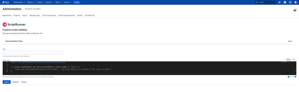

For your requirement, I suggest using ScriptRunner's Custom Script Validator instead of the Simple Script Validator.
Below is a sample working code for your reference:-
import com.opensymphony.workflow.InvalidInputException
if (issue.isSubTask() && issue.parentObject.status.name == 'Done') {
throw new InvalidInputException('sub-tasks', 'Sub-Taks cannot be created if the issue is Done')
Please note that the sample code above is not 100% exact to your environment. Hence, you will need to make the required modifications.
Below are the screenshots for the validator configuration:-

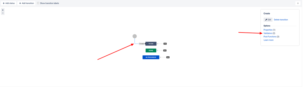

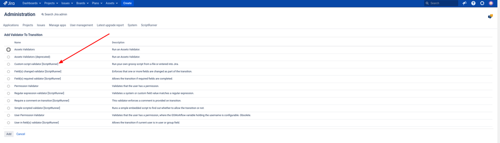

 1. Select the Create transition. Once the dialog appears, click on the Validators link as shown in the screenshot below:-validator_config1.png

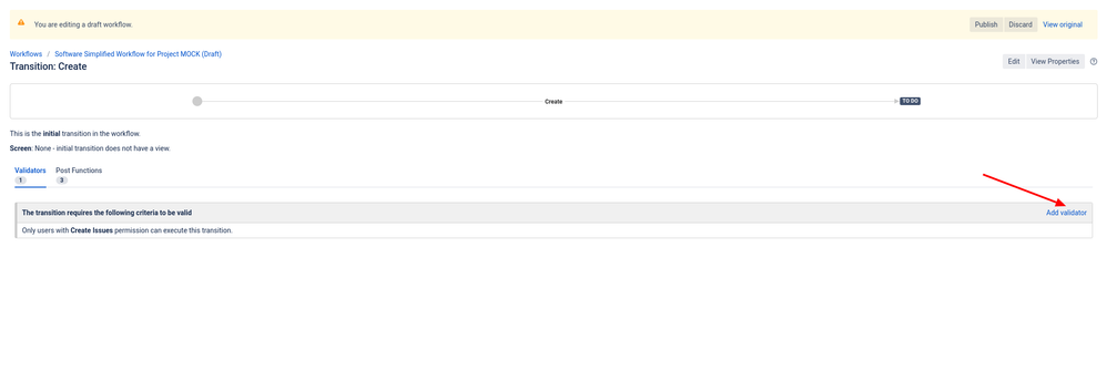

2. Once on the validators Post-Function configuration page, click add validator as shown in the screenshot below:-validator_config2.png
3. Select Custom script validator [ScriptRunner] as shown in the screenshot below
4. Finally, add the sample script I provided into the Inline editor and publish the changes.

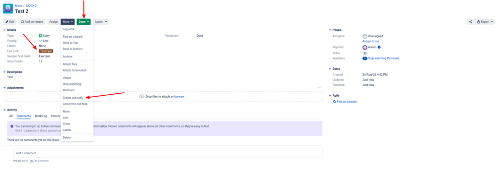

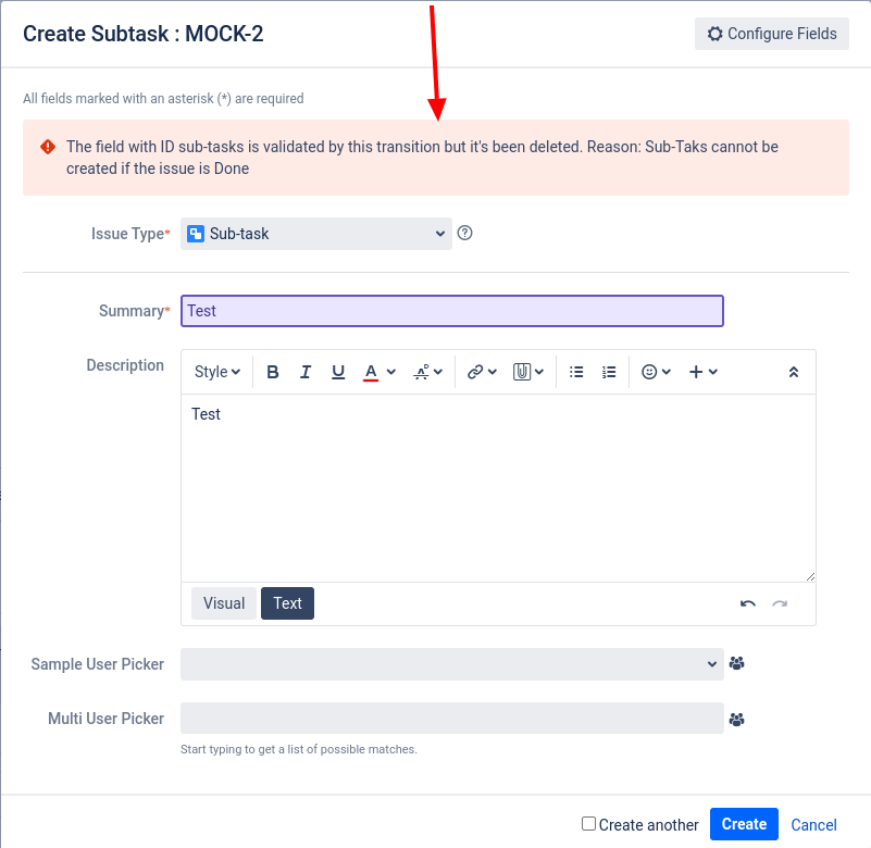

1. To test the validator, I am going to try and create a Sub-task on a Story that is part of an Epic which is in Done status as shown in the screenshot below:-

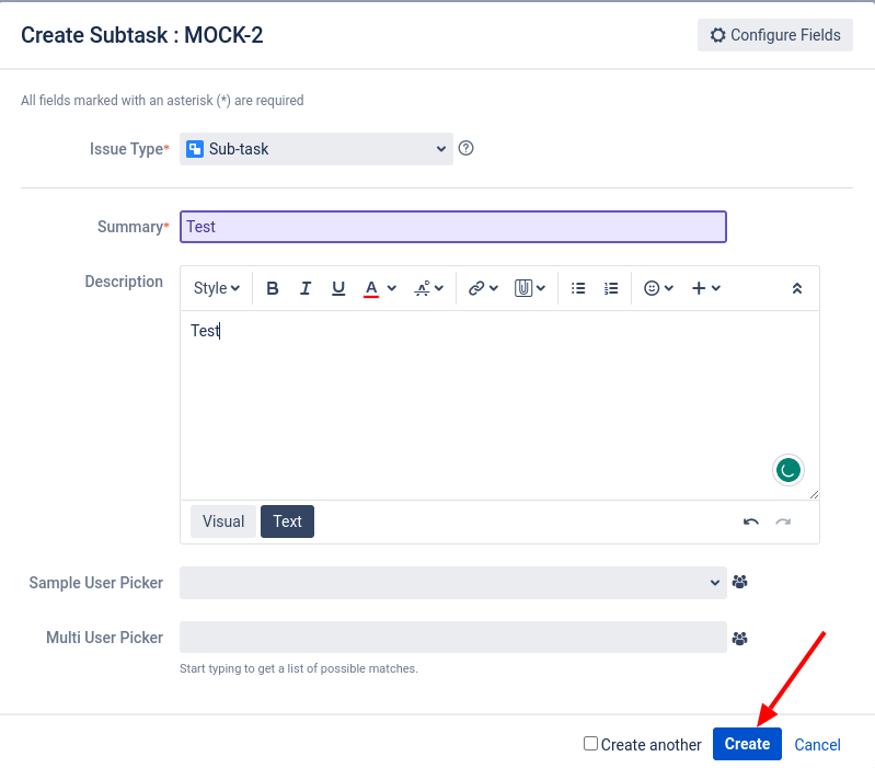

2. I enter some values into the Sub-task fields and click on the create button as shown in the screenshot below:-
3. As expected, the error message does not permit me to create Sub-tasks for Done Issues.

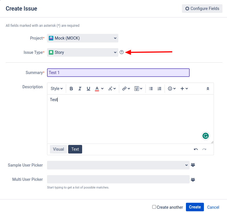

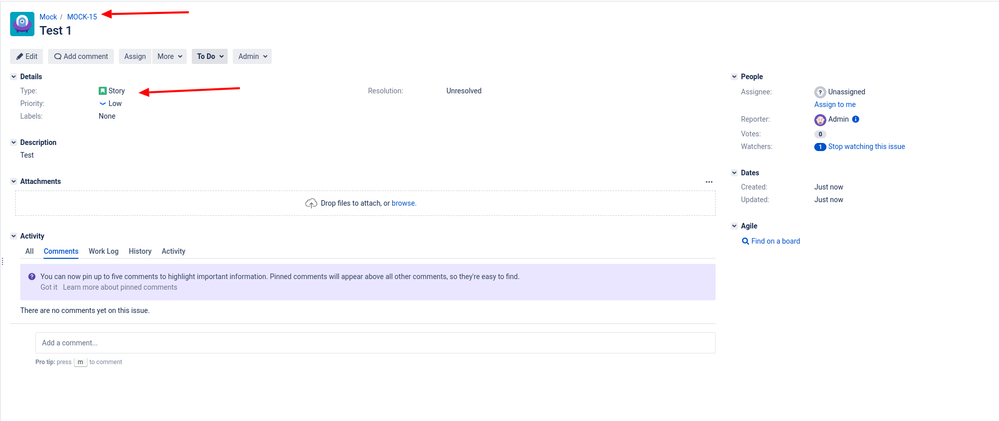

4. Next, I try to create a new Story and enter some details as shown in the screenshot below:-
5. As expected, the new Story is created without any issues.
