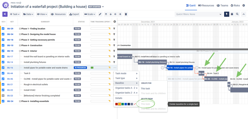

I recreated your scenario, as pictured.
The BU-16 task is "in progress".
Created your Task D, it's BU-44 in the screenshot below.
Cloned the BU-16, so that BU-46 was born.
Recreated the end-to-start links between the tasks.
Deleted the baseline of BU-16, so that the baseline of BU-46 stands for the overall delay.
Yes, your scenario is doable to me.
