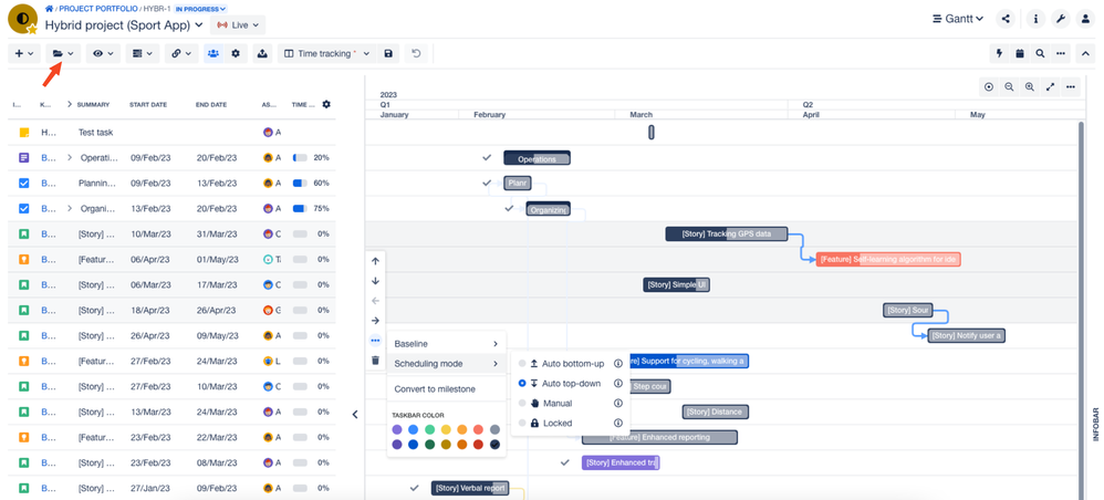

If anyone stumbles upon this post in the future:
For me, bulk changing the scheduling mode directly in BigPicture was the solution. You can do this in the Gantt module of BigPicture as described here.
Alternatively, you can change the scheduling mode for all issues within an entire configuration/box by clicking here in the Gantt module (red arrow):
