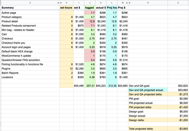

Essentially, I'd like to track even more granularly how many hours we've spent on a project, and which tasks are taking longer than originally estimated. I realize there's a "Time Tracking Report," which is close, but I would like that combined with a burn down chart if possible, and even better would be if it included budget spent based on our hourly rate.
Currently, I'm grabbing the developers' tracked time in each issue, and manually entering this into a spreadsheet against the estimated time under "Original Estimate". I'm also adding this up with our cost per hour to see the budget spent so far.
It would be great if this were automated for me based on the "Accuracy" percentage in the Time Tracking Report. Is there such a plugin or software any of you know of??
This is how I'm doing it manually:
