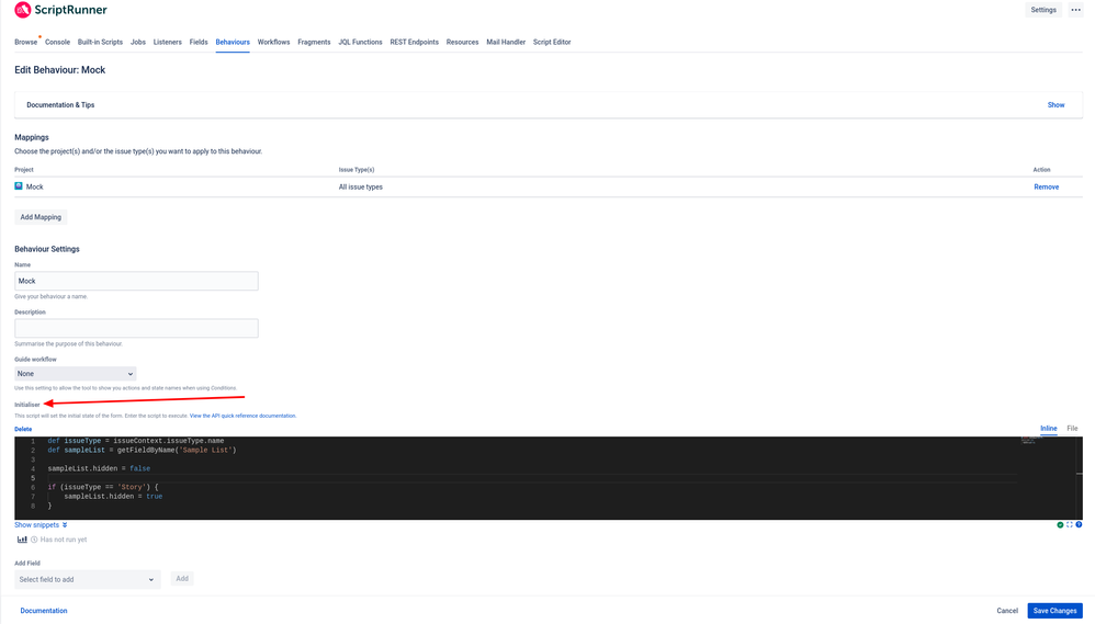

If you intend to use the Behaviour for the Issue Type, this must be done using the Behaviour Initialiser, not the Server-Side Behaviour.
Below is a screenshot of the Behaviour Initialiser configuration for your reference:-
Below is the sample working code for your reference:-

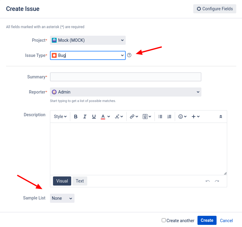

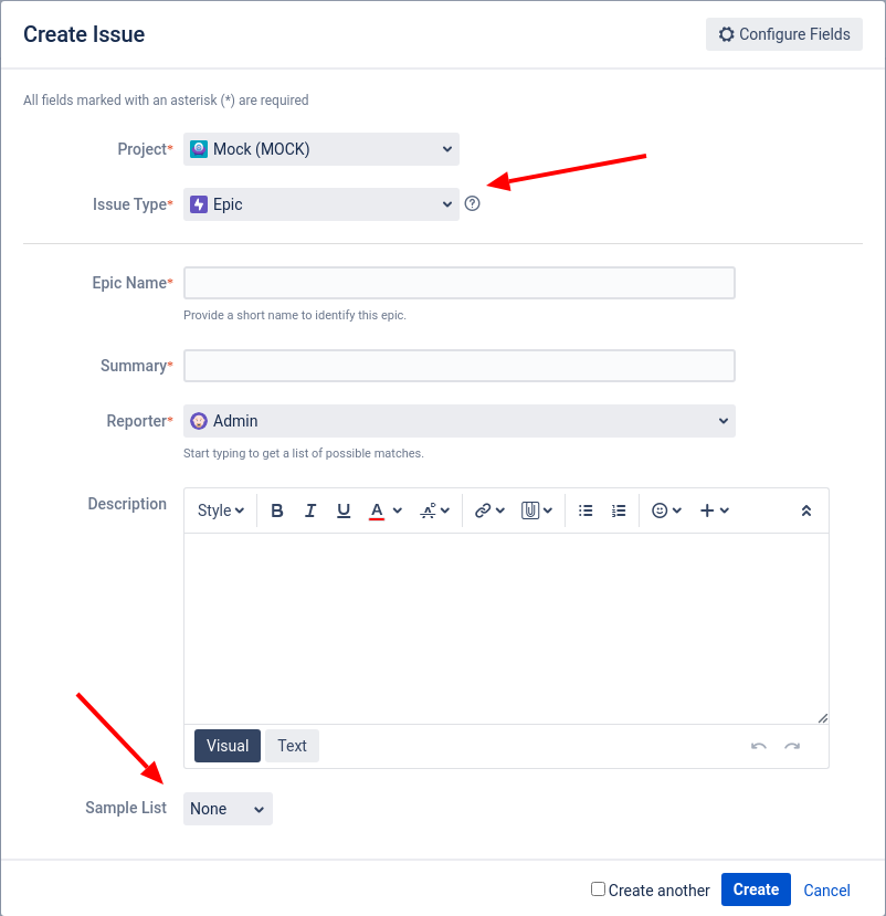

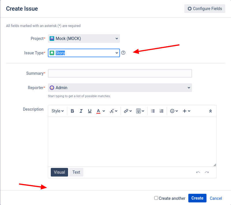

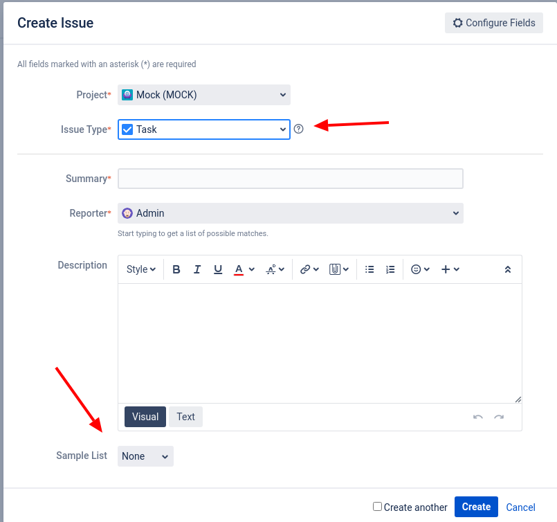

Below are a couple of test screenshots for your reference:-
1. When the Story issue type is selected as expected, the Sample List is hidden.
2. When any other issue type is selected as expected, the Sample List is visible as shown in the screenshots below:-
