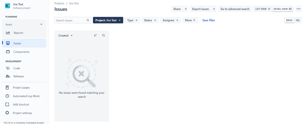

All you have do is create a new board and you will be able to create sprints in the new project.

Could you please guide me how I can do this. This is what i see when i start a new project with shared settings. I cannot access the board settings to create a new board. Please advise.
