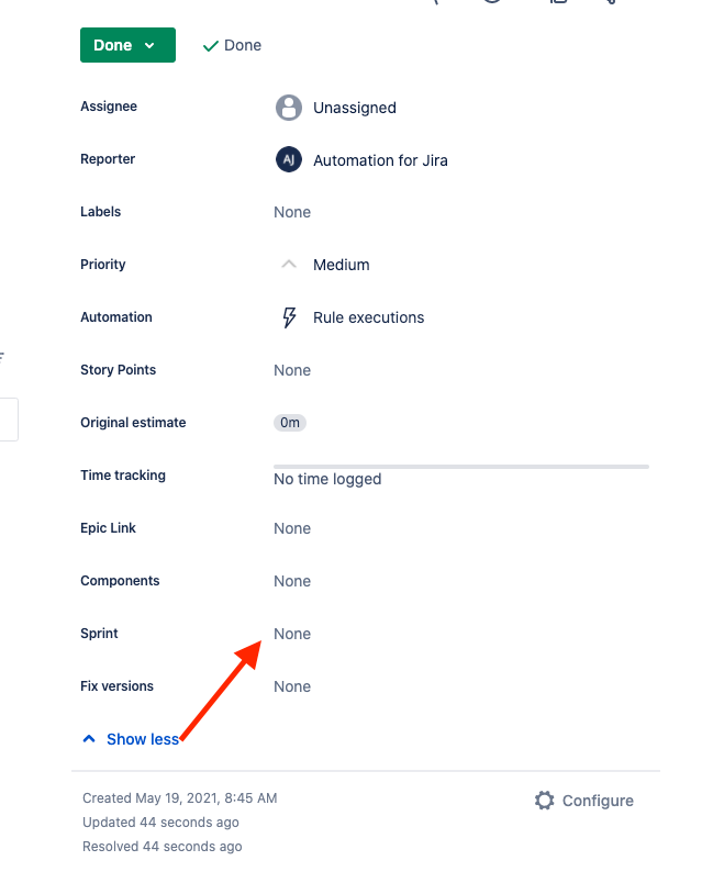

Typically in Company Managed projects that use Scrum, Done issues will automatically be excluded from the backlog.
As for accessing the Sprint field in the issue directly, you should see it in the right side pane of the issue. You may need to click on the Show More link below the field list to see it.
If you still don't see it, you may need to click on the Configure link in the lower right to add the field to your display.

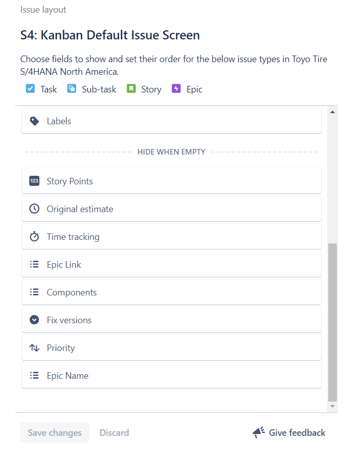

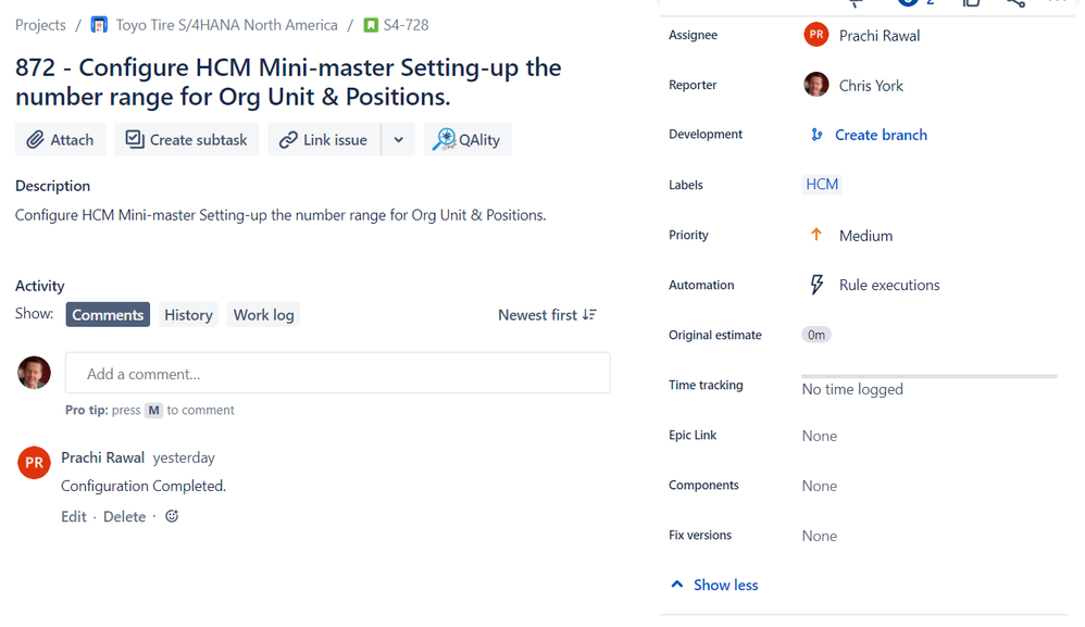

Thanks.  When I go to issue details I don't see the sprint field.  When I go to configure the sprint field is not a choice to add to the issue detail screen
Trudy Claspill
May 28, 2021
Can you provide screen images of what you see?
What type of issues are these?
Chris York
May 28, 2021
Trudy Claspill
May 28, 2021
Well, that's a little unusual.
I did some experimenting and I found that you can set up a scrum board for a project and add issues to sprints in the Backlog screen even if you don't include the Sprint field in the screen(s) for the issues.
So, it would appear that is what has happened in your case.
To fix it, you will have to modify the Screens associated with the Screen Scheme (associated with the Issue Type Screen Scheme) associated with your project, and add the Sprint field to the screens. Then it should be available to add to your Issue View under the Configure option.
