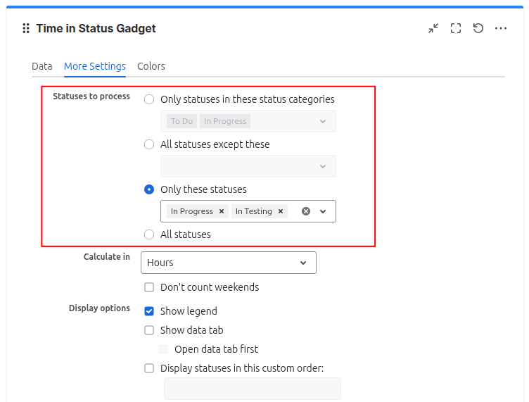

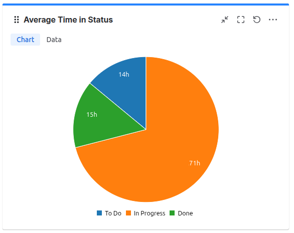

If you would like to try out a mktplace app for this requirement, pls explore
Time in Status Reports
With this app you generate time in each workflow status for multiple issues with multiple filter and grouping options.
One the many reports which the app has is "Average Time in Status", which can meet your use case.
With Status grouping feature, can help you define your own cycle time / issue age time and view the averages of the same. Also the app has 20+ reports to meet a variety of use cases.
You can set your own working calendar to exclude weekends and holidays from the time in status calculation. Also the app can be added as a dashboard gadget.
More details here.
Disclaimer : I am part of the app team for this add-on

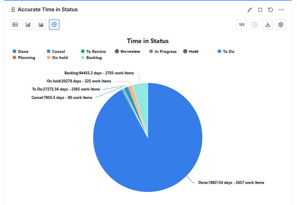

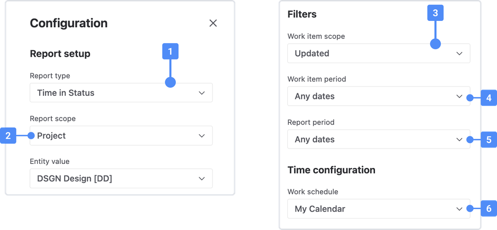

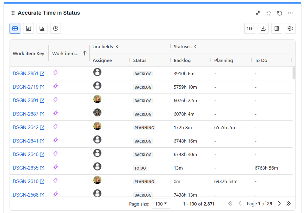

If you are open to trying a marketplace app, I can suggest the Accurate Time in Status gadget developed by the Time in Status app by SaaSJet.
After you install the app, find Accurate Time in Status (by SaaSJet) in the search results and add it.
In the gadget settings, select the project you need, and you will see only the statuses relevant to the selected project/filter.
You can also set up the work item scope, work item period, and report period, and configure the work schedule.
The report can be shown in a chart or in a table, depending on your needs.
Disclosure: I'm part of the Time in Status team.

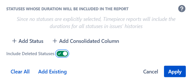

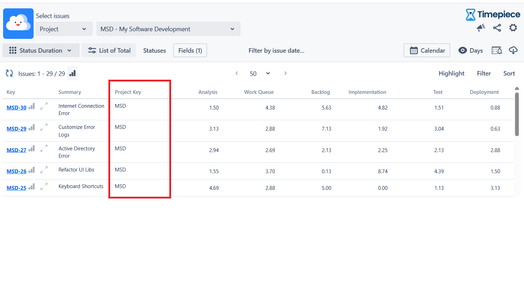

If you are open to using a Marketplace app to get a clean, accurate view, you can easily bypass this clutter using Timepiece - Time in Status for Jira.
Timepiece includes a highly customizable Dashboard Gadget that handles statuses much smarter:
Auto-Filtering by History: If you select your project or custom JQL filter and leave the "Statuses" selection empty, Timepiece will automatically generate the report using only the statuses it actually encounters in the issue histories of your selected filter. It completely ignores the rest of the instance-wide clutter.
Hide Legacy Statuses: Timepiece has a dedicated "Show Deleted Statuses" toggle. By keeping this disabled, it automatically excludes unused or deleted legacy statuses from your reports.
Team-Managed Project Keys: If you do want to manually select statuses from the dropdown, Timepiece adds the specific Project Key next to the status name. This way, you know exactly which "In Progress" or "Done" you are selecting, even if multiple team-managed projects share the same status names.
You can configure the gadget to show the Average time, and it will give you exactly the clean, filtered dashboard view you are looking for. You can find Timepiece - Time in Status for Jira on the Atlassian Marketplace.
Full disclosure, I'm on the team that makes Timepiece. Hope this helps!
