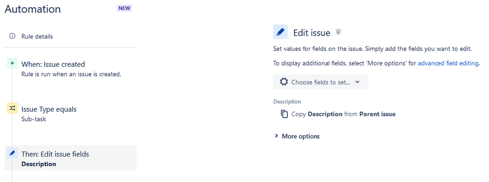

Hello @Rocsana Chereches
As mentioned by @Tessa Tuteleers automation rule is the way to achieve this. For your reference please find below a similar implementation. this can be customised based on your requirements.
Please feel free to share if need any support with the rule.

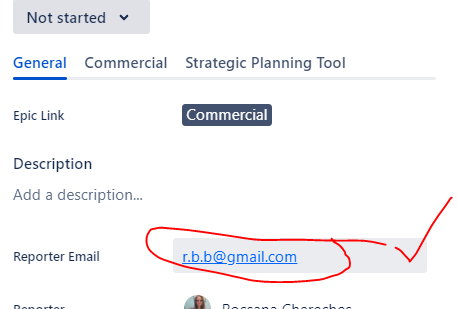

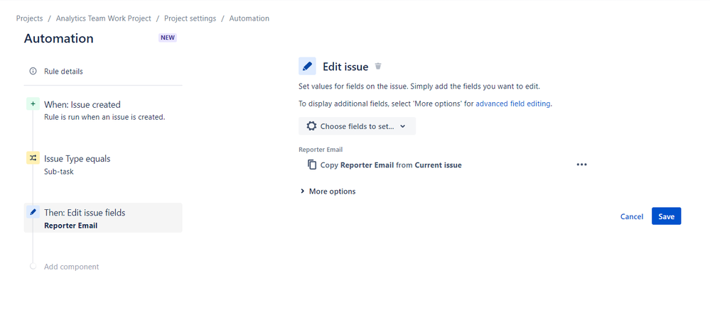

I did try to replicate this automation rule for the sub-task to copy from the parent issue the 'reporter email' field (parent issue was already create and then I created a subtask).
The automation was successfully enablereporter email.PNGtest did not work.PNGunfortunately it still does not work. Sub task does not get populated with the email from the parent issue...
Can you see anything I did wrong here?

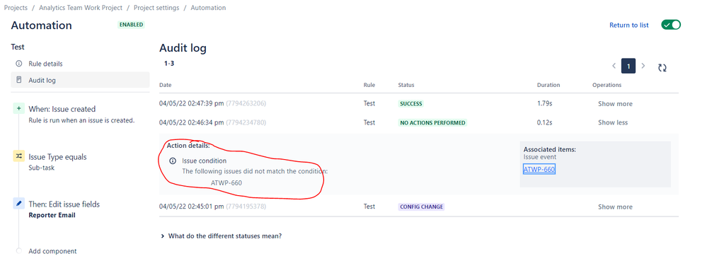

In the next screenshot, I checked the audit log and it says that the condition was not met by the issue and subtask I created but I don't see how not.
I would appreciate any input, thank you
Tessa Tuteleers
May 4, 2022
Hi @Rocsana Chereches ,
You are showing the action details of the issue you created, which is a task / story / ... .  so you don't need the copy as it is not a subtask (NO ACTIONS PERFORMED)
Please show the next log (SUCCES).
Also, your action says: copy Report email from current issue.

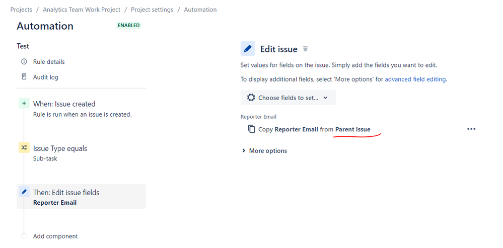

Please change that to copy reporter email from parent issue (to get the value from the parent, now you just get the value from the subtask itself, which is still empty)
- Tessa
Rocsana Chereches
May 4, 2022
My rule looks like this now - and it works! thanks so much Tessa.

Tessa Tuteleers
May 4, 2022
The audit log you shared showed 2 "entries"
The entry you showed was the one where you created the task, the next is the one where you created the subtask, so the one you showed did indeed not pass the condition, but if you showed us the next one it would have showed that it did pass the condition. (but since your copy action was wrong it would have copied the data from empty -> empty so still not the right result. )
Glad you got it fixed, happy automating!
- Tessa

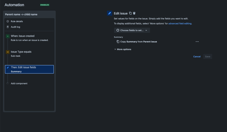

Alkanz Ali
June 12, 2023
i am facing the same issue as Rocsana. I am trying to automate a rule so that parent task name can be copied to subtask name.
here is my rule screenshot
and the below mentioned screenshot is of the audit log and it says that the condition was not met by the issue and subtask I created but I don't see how not.
Please help, your assistance will be much appreciated
