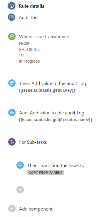

Dear ALL,
being trying to set a rule up such that when the status of a Parent changes for example to "In Progress", the associated first sub-task status is set also to "In Progress".
I know usually it's the way around but I need this case.
The sub-tasks are for example 3 but I need a rule to change the status only of first sub-task.
Is this feasible in Jira DC.
Attached what I've done so far but the rule changes the status of all the sub-tasks.

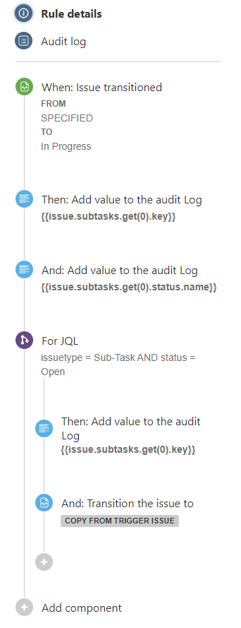

Do you mean like the one I have attached.
If so, I get performance issues now as there are a lot of sub-tasks on my Jira Project and the limit has been execeeded.
Thanks in advance and have a nice week.
Kind Regards,
Bill Sheboy
May 6, 2024
I was suggesting to add to your branch JQL (or replace it with):
key = key of the desired subtask
That will ensure you only get the one you want.

In your response to John, you noted it was this one: {{issue.subtasks.get(0).key}}  If that is always the case, you could use this JQL:
key = {{issue.subtasks.get(0).key}}
However that may create problems if anyone re-orders the subtasks in the issue.
