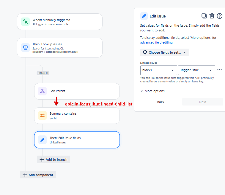

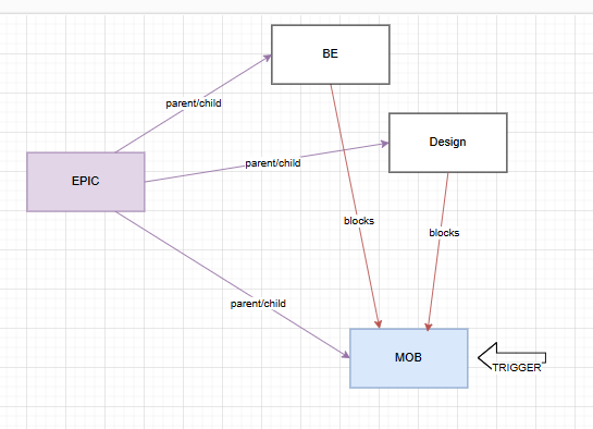

  • Another to link them together using the logic shown in the image below.
And now I'm stuck even on this seemingly simple automation!
If I set the trigger issue as the Epic itself and then use the 'for children relation' branch, I'm unable to utilize IF-ELSE conditions to process each task one by one, check its presence, and then create a link.
If I set the trigger issue as one of the child tasks, it seems I can't retrieve a list of its siblings. Moreover, if I use the 'for parent' branch to go one level up, I can't then target the siblings.

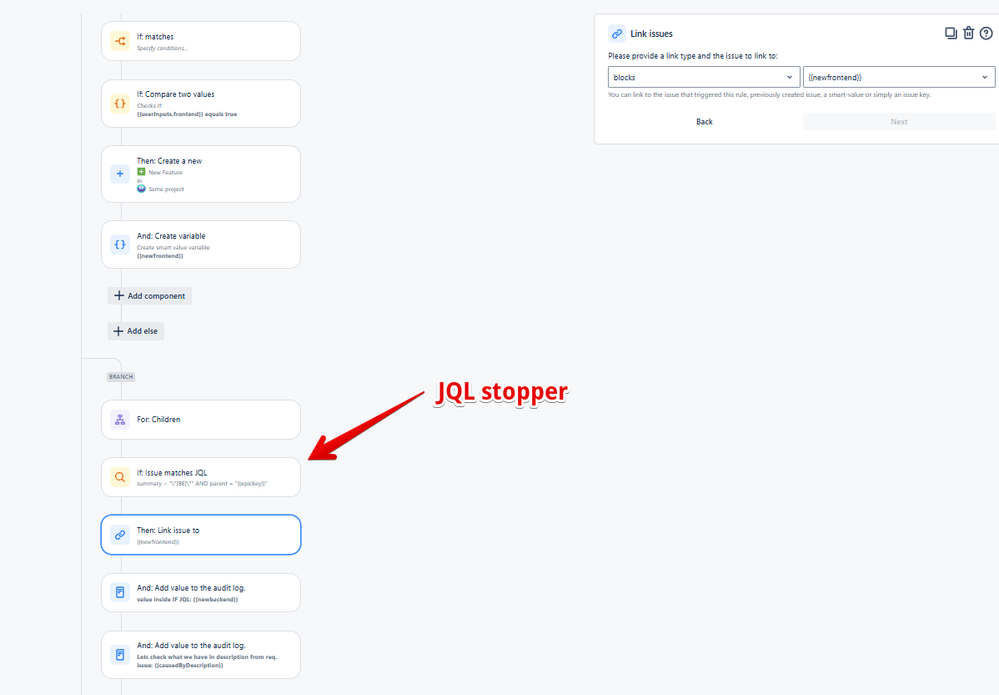

Are all of the tasks created at one time in a single rule?
If so, you could still perform the linking in that rule using this approach:
  • As each issue is created, save a variable with its key.  e.g., varBEKey, varDesignKey, varMOBKey
  • Then use branch on JQL to access the issues and add the links needed.  As the keys are already stored, any branch parallel processing should not be relevant.
    • FYI, I have recently observed that branch on JQL with one-and-only-one issue, such as key=TEST-123, now runs sequentially (i.e., inline to the rule steps) rather than in parallel.  Although I wouldn't rely upon that as it appears to be undocumented behavior.
  • This will lead to a rule with about 15-20 steps, given what you have described

After brief test (with a single linking) i managed to get desired result! My assumption about 'variable belongs to the branch' was wrong! Due to parallelness my breakpoints were unable to catch the value, but your method with JQL 'stop' seems works.
So now I can create 5-6 issues for each work type via IFs based on user input, and then check each children with a JQL stopper and link them as team wanted.
