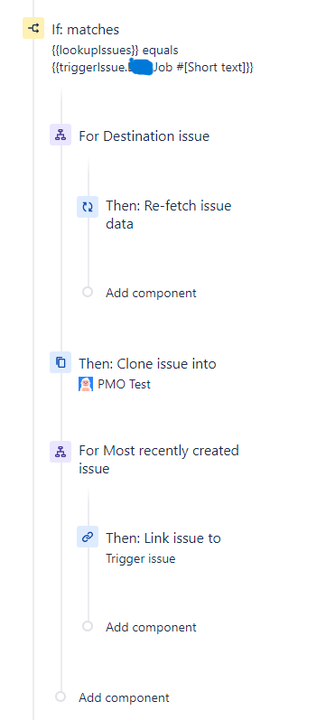

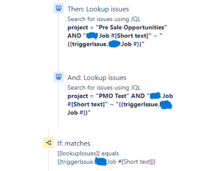

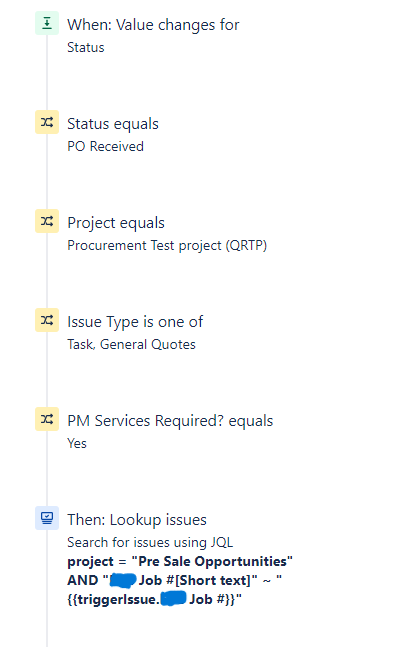

Yes, I've created this.  My requirement here is - if the job no# is already found in 'pre sales opportunities', I need it to be cloned in 'PMO test'. However, this automation is cloning the data from 'procurement'

Your first problem is that you have two Lookup Issues actions next to each other, and then try to use {{lookupIssues}} in a comparison.
{{lookupIssues}} is a list object, and it will contain the results of the last Lookup Issues action. This comparison is referencing the issues found by the second Lookup Issue action.
The results of the first Lookup Issues actions are wiped out by the second Lookup Issue action.
Why do you have 2 Lookup Issues actions? Which of these is project Y and which is project Z?
Your second problem is that you are trying to compare a list (the {{lookupIssues}} smart value) to a single value {{triggerIssue....}}. This is not a valid comparison.

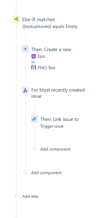

Vishnu
November 16, 2022
Hello @Trudy P Claspill
Thanks for your reply.

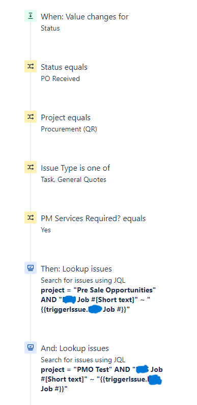

Procurement(QRTP) is X, pre sales opps(PSO) is Y and PMO(PT) is Z.

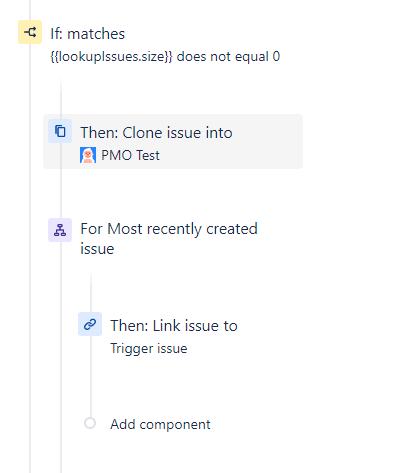

I'm able to create new epic if there are no matching results from lookup issues. My concern here is when there is a matching job no found in pre sales opps(Y), I want that looked up issue to be cloned in pmo(Z). However, with this automation rule, the procurement(X) ticket details are getting cloned to pmo(Z)
 As suggested, I'm trying to work on one scenario but facing the above issue.
Trudy P Claspill
November 17, 2022

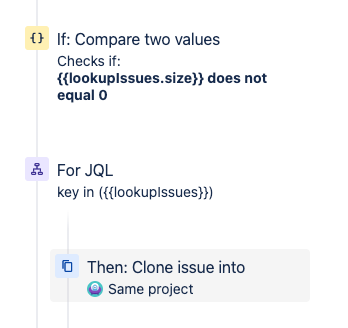

After checking the size of the Lookup Issues results set and finding it is not 0 you need to add a branch to loop through those results and clone the issues within the results. Use Branch / Related Issues / JQL . Execute the Clone action within that loop.
