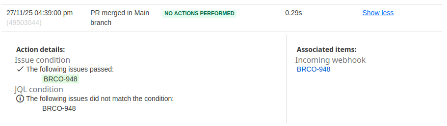

The problem is that in this automation we have a JQL condition that checks whether there are no open PRs for the issue and somehow for an item this condition has failed even though the trigger of this automation is merging a PR.
Here is the rule:
Here is the log:

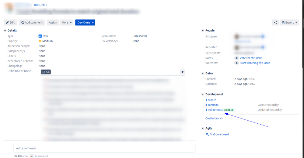

Here is the issue:
So it can be seen that there is only 1 PR for the issue. And it being merged called the automation that failed at the JQL check for having no open PRs.

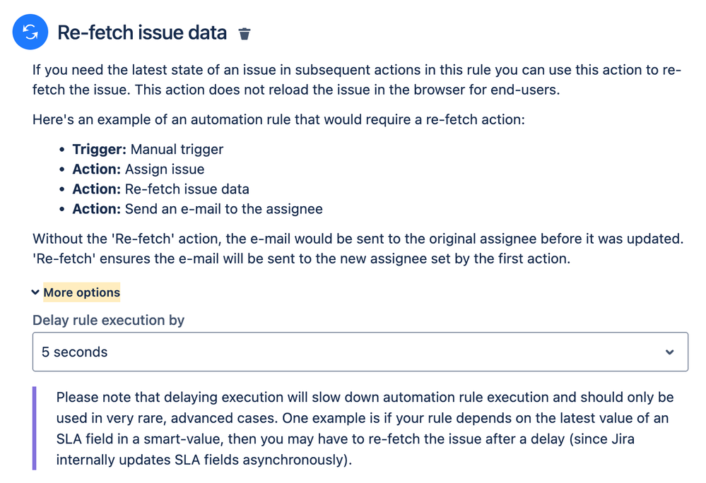

Hi @Anna Mjau,
Try adding the Re-fetch issue data action with a 5 sec delay just after the Incoming webhook trigger:
Just to see if there is a difference.
If the rule works correctly with this delay, then I would reduce the delay to 1 second and check if 1 second is enough for Jira to index the changes from Bitbucket.

What you’re seeing is a fairly common race condition: the webhook fires immediately on merge, but Jira hasn’t finished ingesting and indexing the PR data yet.
In these cases the JQL evaluation runs against stale metadata, so the rule fails even though the PR is actually merged. A couple of things that normally help:
• Add a short “Re-fetch issue data” action before the JQL step
• Add a small delay (manual or scheduled branch) to let the PR status propagate
• Validate PR status via a secondary condition rather than a single JQL check

Hi!
Thank Youo for the answer!
I tried adding the Re-fetch issue data (even twice) before the JQL condition, but that did not work.
The second point - add a small delay - is that an action that is possible in Jira automation? I could not find it.
