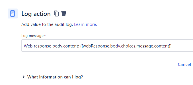

I have a manually triggered automation rule. It pings OpenAI, and returns a smart value. This smart value has a pattern (like an array but not officially) and I'd like to know if I can split the value and create multiple subtasks from it. For example:
{{webResponse.body.choices.message.content}} will return Subtask1,Subtask2,Subtask3,Subtask4 via log.
So I wanted to use {{webResponse.body.choices.message.content.split(",")}} to separate them by commas and hopefully use them as new Subtask names and create subtasks from them.
Is this possible? I've attempted using the split function of smart values and haven't had luck.
