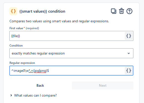

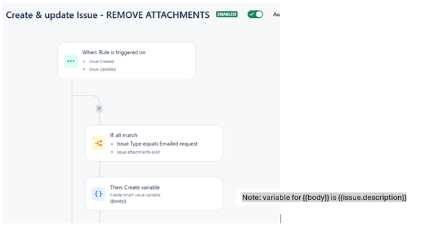

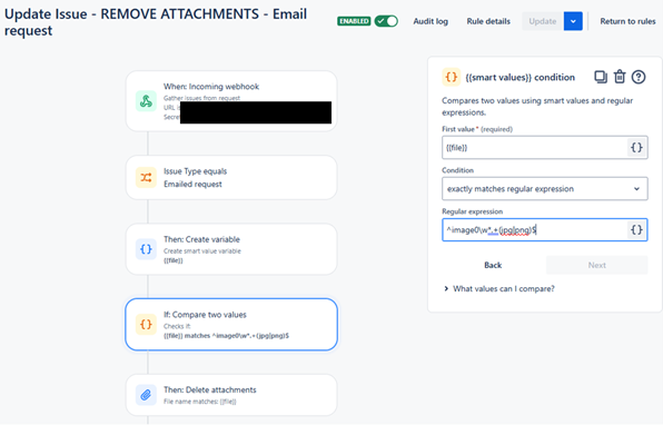

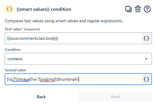

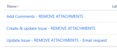

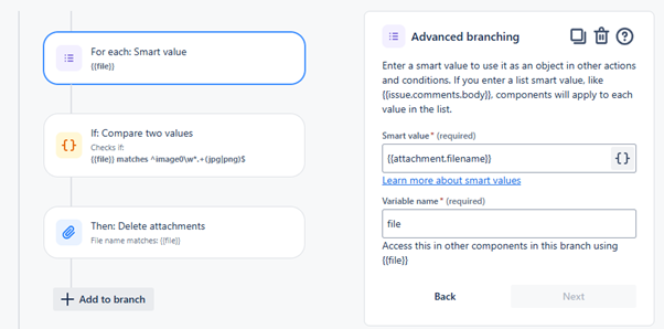

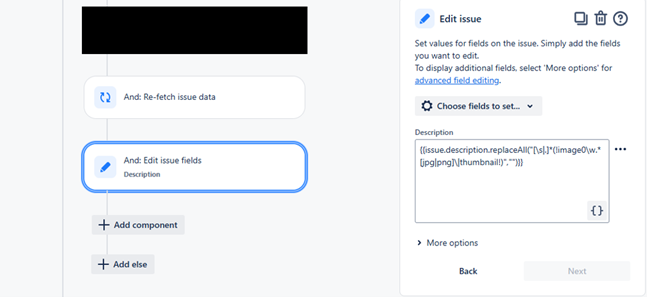

I ended up splitting it into multiple automation rules, to try and mitigate the possibility of wanted image attachments being removed, i.e:
So for the create/update rule, I had the following:
The branching component essentially checks if the attached image has the [image#.] as the file name, since signature image attachments seem to have this naming convention (at least in my experience). So if your attachments have a different name they should be fine? However you will need to test.
And the final edit issue component rewrites the issue description, without the attachments/filenames.
Hope this helps?
Simon Galiazzo
April 9, 2025
@Michael Woolfall zoomed in on the smart value conditions from the 3 rules I setup, see attached:
