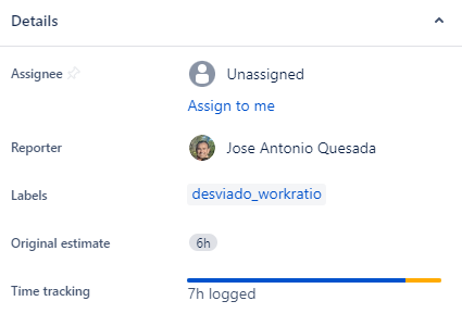

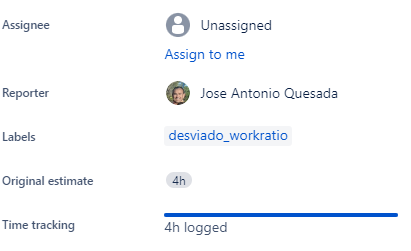

Jose Antonio Quesada
February 10, 2023

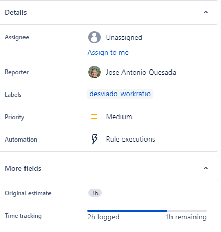

Hi @Kian Stack Mumo Systems
Thanks for your proposal, but it doesn't work.
It always apply the label.
When time logged is greater than original estimate (it's OK)
When time logged is equal to original estimated (it's KO)
When time logged is smaller than original estimated (it's KO)

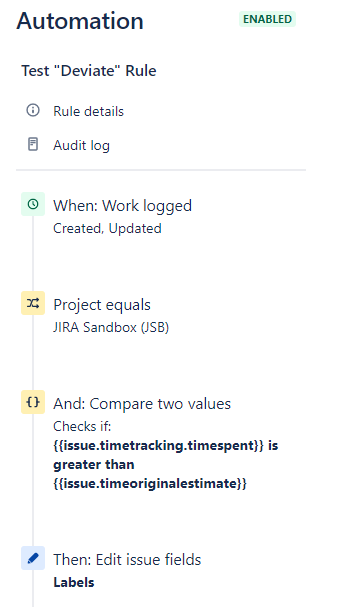

This is the rule configuration:
Thanks,
Jose

Thanks for highlighting that! It looks like in Jira Cloud, the workRatio field is actually on a scale of 0-100 rather than 0-1. Try doing workratio > 100 instead of workratio > 1!

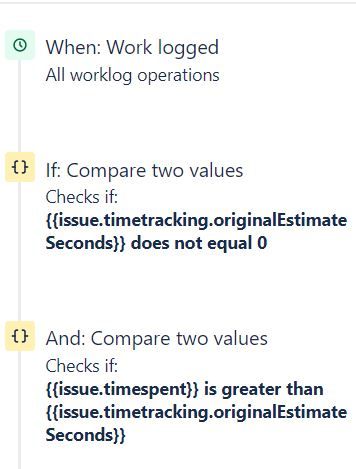

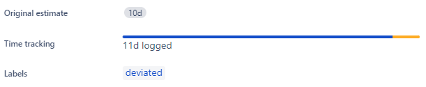

Kelly Arrey
February 9, 2023
Here's an example rule:
And here's the output:
February 9, 2023
That's a good solution as well! One benefit of this is that you could take other actions as well. For example alerting the assignee that the issue has now exceeded allotted time!

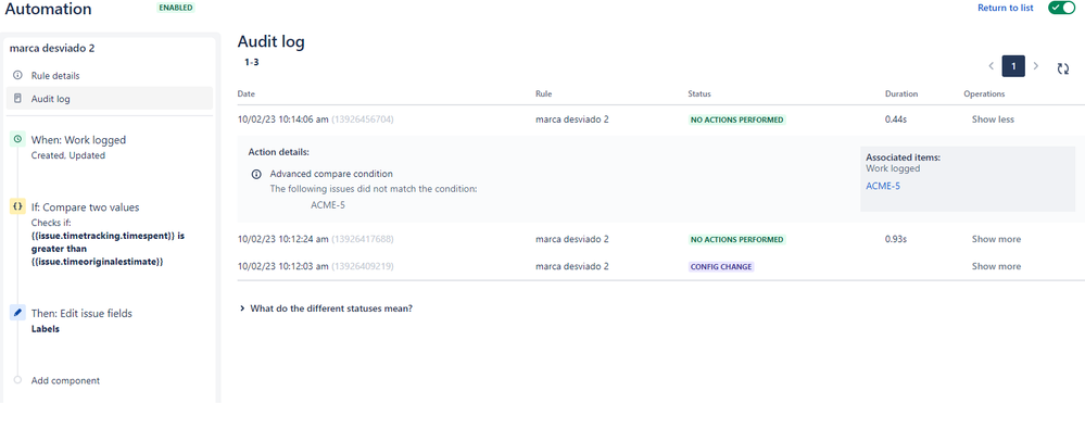

February 10, 2023

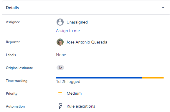

Thank you very much! I've tested it but I can't get it to work.
Jira says the issues does not match the conditions, but the issue is deviated:
The support documentation (https://support.atlassian.com/cloud-automation/docs/jira-smart-values-issues/) shows all the available fields, and I can't find the field {{issue.timeoriginalestimate}}
Maybe here is the problem?
Thanks in advance.
BR
Jose
Christoph Päper
November 15, 2023
That list of smart values is not exhaustive. Check out the description in https://support.atlassian.com/cloud-automation/docs/find-the-smart-value-for-a-field/ to find more.
The fields used for the smart values `{{issue.timespent}}` and `{{issue.timetracking.timeSpentSeconds}}` may have different access permissions, but they should both hold the same numeric value (in seconds) as `{{#issue.worklog.worklogs.timeSpentSeconds.sum}}` would yield (which may have other access permissions). If you don’t have sub-tasks or don’t track time therein, `{{issue.aggregatetimespent}}` will also be the same.
The long form would be `{{issue.fields.timespent}}`, by the way, but `fields.` can always be omitted and `issue.` is implied and thus optional much of the time, so `{{timespent}}` will work as well. Smart values also support reference by (non-translated) label, so `{{Time Spent}}`, `{{Remaining Estimate}}` and `{{Original Estimate}}` should work as well, but `{{remainingestimate}}` and `{{originalestimate}}` will fail, because they are actually called `{{timeestimate}}` and `{{timeoriginalestimate}}`, respectively (also available with `aggregate` in front).
The `issue.fields.timetracking` field holds the time already spent, the original and the remaining estimate and each value as a number in seconds and as a formatted string with units; it doesn’t keep information about sub-tasks:
"timetracking": {
"originalEstimate": "30m",
"remainingEstimate": "0m",
  "timeSpent": "1h 30m",
"originalEstimateSeconds": 1800,
"remainingEstimateSeconds": 0,
"timeSpentSeconds": 5400
Likewise, each work log entry also holds the time registered in two fields, textual `timeSpent` and numeric `timeSpentSeconds`. Always make sure you use the latter for calculations. Depending on context, `{{timespent}}` could refer to either of  `{{issue.timespent}}`, `{{timetracking.timespent}}` or even `{{worklogs.timespent}}`.
You might find the same duration values in another field, `{{progress}}` (and `{{aggregrateprogress}}`):
"progress": {
"progress": 5400, // = timespent
"total": 5400, // = max(timespent, timeoriginalestimate) or timespent + timeestimate?
"percent": 100 // = round(progress / total * 100)
There is a pre-calculated field `{{workratio}}` = `{{timespent.divide(timeoriginalestimate).multiply(100)}}`, but  no `{{aggregateworkratio}}` that would consider sub-tasks. Unlike `{{progress.percent}}`, it goes beyond 100.
