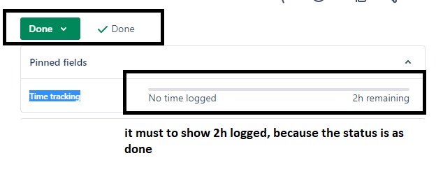

Hello everyone, i'm with a problem in my jira that when an subtask change the status to the the status done,
the Time tracking
keeps on the 0, but i need the time tracking be filled with the same time that was estimated in this case i estimated 2.

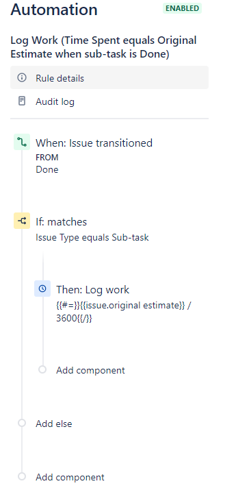

I tried to create a automation to do this but dosent work as in the image bellow

Hi @Lucas Silva Dantas Abrantes - The first thing I see is that this is triggering From Done instead of To Done.
If this doesn't solve your issue, can you please share a screenshot of the audit log for the rule as this will provide additional information.

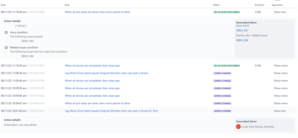

hi @Mark Segall , the automation didn't worked and didn't have been executed so it didn't appear in log
Did you change the Trigger as mentioned in my last comment?

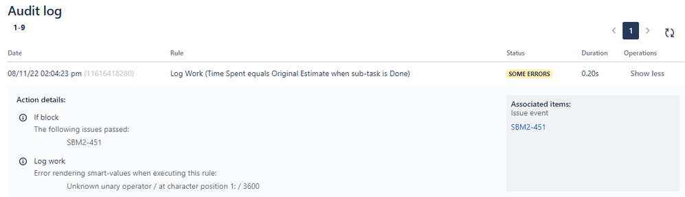

Sorry, I didn't see the screenshot with the error before my last response. It's not liking the calculation you're using:
{{#=}}{{issue.original estimate}} / 3600{{/}}
What happens if you simply use this?

@Mark Segall Thankyou very much i changed to
{{issue.original estimate}}And then it worked perfectly with all the other automations thank very much i appreciate your support
