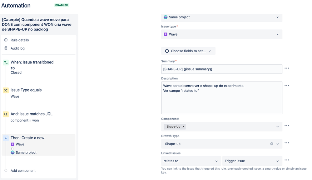

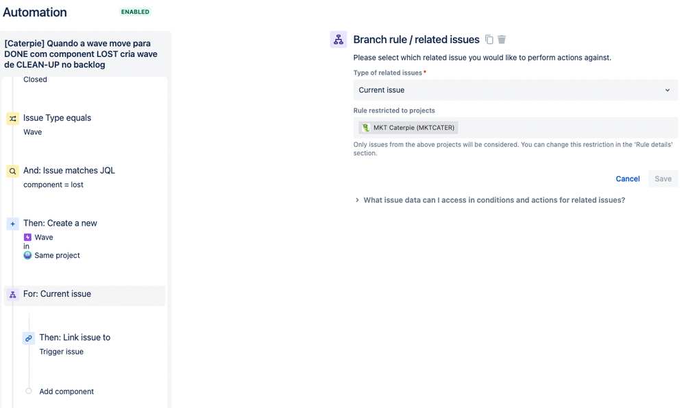

  1. Hi Mark, thanks much for your reply.
    Yes, you're correct about the assumption that I did a "separate action after the create issue".
    Mark, I've tried both options that you've suggested, but it's still now working:
    What I'm trying to do is to move an Epic to done status.
  2. If this Epic has a certain value in the field "component", a new Epic will be created. So far, this automation is succeding in doing this.
  3. Then, the automation must relate/link this new epic to the trigger issue (that is also an Epic). This is not working.
    I'll add the screenshots of both solutions that you suggested.
    Please, can you help me to figure out what's happening?
    Is there any other way to link an epic to an epic. I've tried to use "epic link" for this, but it also doesn't work.

Your first screenshot looks like you configured things correctly.  The only thing I can think of as to why it wouldn't work is that the Linked Issues field isn't on the Create screen for your Wave issue type.  So, I would check:
  1. The rule's audit log to verify that it shows successful
  2. if the Linked Issues field on the Wave Issue Type CREATE screen
To explain your second approach, the branch relationship type is set to current issue which would be the trigger issue.  Instead, it should be All Created Issues.
