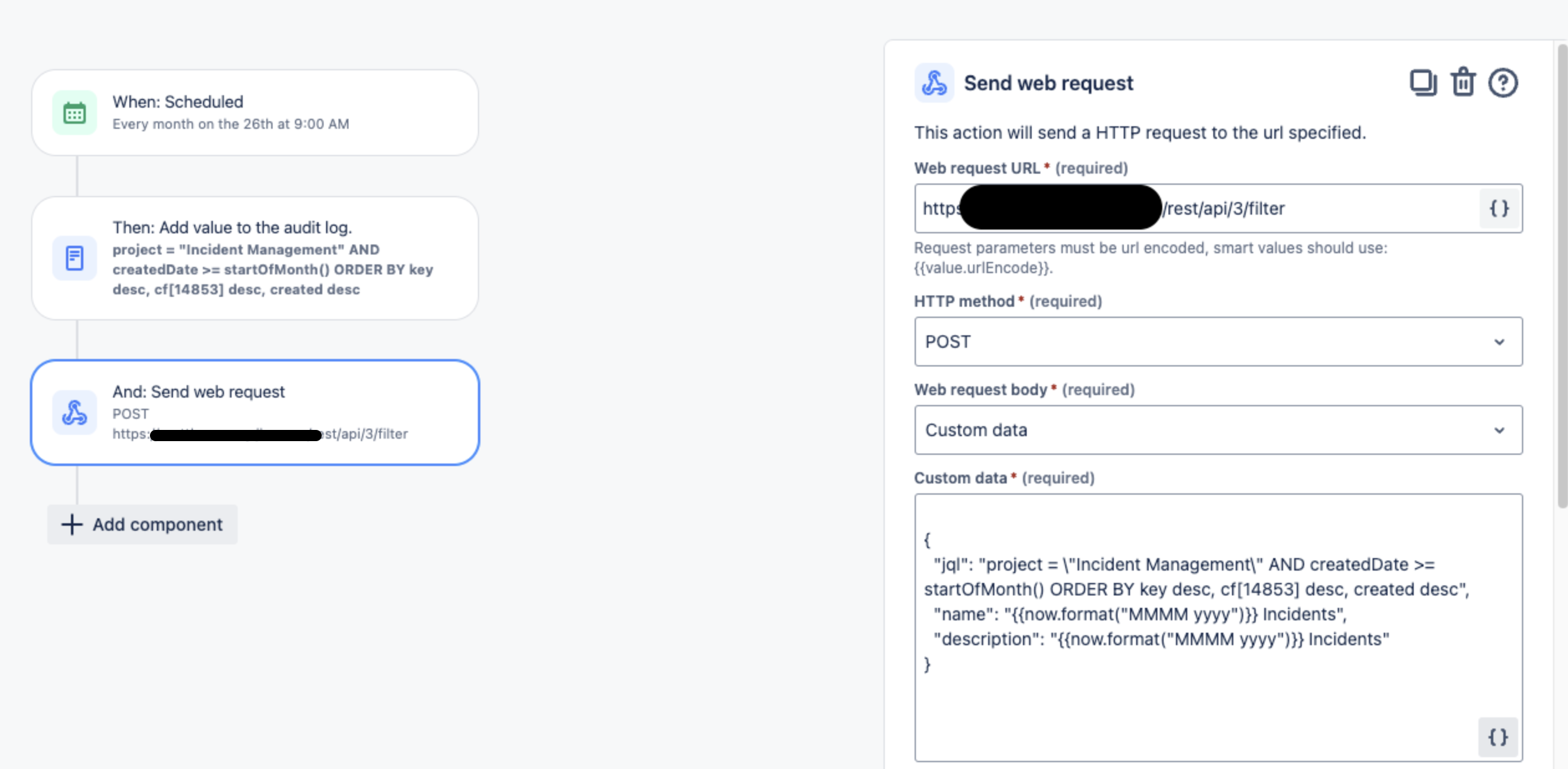

The automation is currently set up below, which is not what we want because the filter needs to look specifically for the month it ran and change each month it runs. If I look at the filter today 2/5 that was created in January, it would show results for this month because of the part "createdDate >= startOfMonth()"
How do we do this in the automation?

You are correct that this expression is the cause of what you are observing:
Instead you would use {{now}} and the startOfMonth() and endOfMonth() functions, formatting the results to work with JQL.  For example:
     createdDate >= {{now.startOfMonth.jiraDate}}
AND createdDate < {{now.endOfMonth.jiraDate}}
Please note well: I recommend not running this rule within 24 hours of the first / last days of the month or time zone impacts could cause problems with the dates selected.  Alternatively, the time zone functions could be used to force {{now}} to your own location before using the start / end functions.

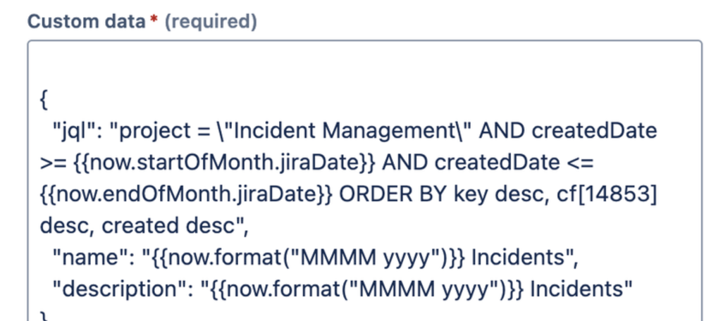

Yes that worked!!! Thank you!!
Pasting in final results in case anyone needs it.

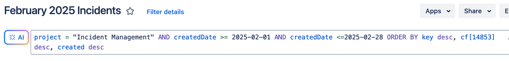

Filter created now explicitly searches for that month
Screenshot 2025-02-06 at 3.02.48 PM.pngScreenshot 2025-02-10 at 10.08.58 AM.png
