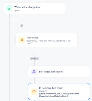

I need some help with an automation. I have to check if delivery date for an issue is within the start date and end date of a sprint (sprint in which the issue is). For e.g, if the issue's delivery date is not within the start date and end date of the sprint (sprint in which the issue is), then the delivery date will be updated to NULL.
The issue is that I cannot check if the date 'is between' the sprint end date. I have only options greater than and less than. Any help on this please?

Next thing, confirm the type of your custom field.  If it is a date picker field you can compare the value directly with no conversions or formatting.  That means removing both value from the comparison and the formatting to jiraDate.
If the field is another type, you will need to ensure the values can be compared.
The same methods can be used with the startDate for the sprint.

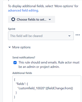

I managed to use the field change in the advanced editing part and it is working but partly.
else consider as an error (e.g. delivery date = 15-Nov-2023, new sprint dates [01-Dec-2023;15-Dec-2023]
leave delivery date as-is
sprint = previous value (null or DEF)
end if
This is working fine when there is an actual value for sprint, in our case DEF. But for the case where it was NULL previously, it does not work and I get an error "Error while parsing additional fields. Not valid JSON."

For your first question, I believe you will need to conditionally set the sprint either to the from value or to null.  If that does not work, let me know so I can experiment a bit.

For the first point, believe you will need to conditionally set the sprint either to the from value or to null - This is not working. Grateful if you can send me the code/automation for this one?

  • The sprint field can in fact be cleared by just editing the field in a rule and leaving the value empty.  And so the rule conditions can just use the conditional logic to set the field to either empty or to the prior sprint id value, with {{fieldChange.from}}

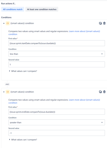

For the specifics of the smart value compare...
The first one tests if {{issue.sprint.startDate.compareTo(issue.duedate)}} is less than 1, meaning the start date is before, or equal to, the due date.
And the second tests if {{issue.sprint.endDate.compareTo(issue.duedate)}} is greater than -1, meaning the end date is equal to, or greater than, the due date.
