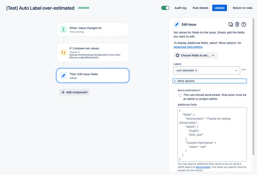

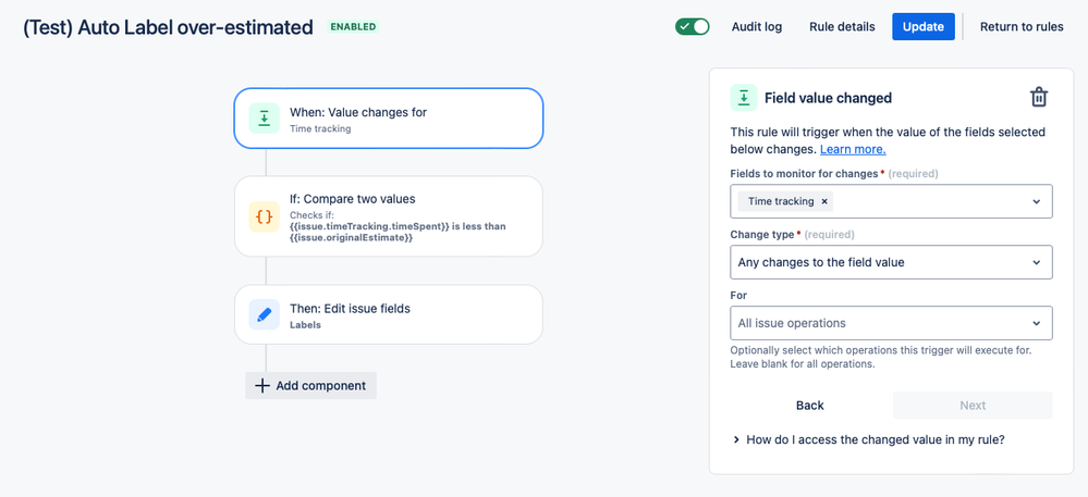

I want to create an Automation that sets
  1. the label "under-estimated" if the Time Spent is greater than the Original Estimate
  2. the label "over-estimated" if the Time Spent is smaller than the Original Estimate
Her are my Screens for Rule 1:
It seems that my approach is not working.

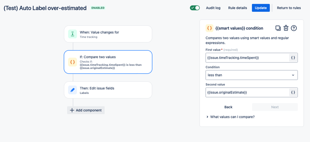

Hi @Dominik ,
The original estimate field should be accessed via {{issue.timetracking.originalEstimate}}. You can double check this by following this how-to by Atlassian.
There is one more complexity you'll need to consider.
The output of originalEstimate and timeSpent is provided in the period format (1d 2h etc.)
These strings do not compare well, for example 1d would be smaller than 2h, so you instead need to compare originalEstimateSeconds with timeSpendSeconds. This will act as you expect.

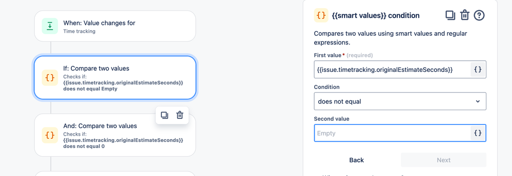

Hi @Dominik ,
To not apply a label when no estimation has taken place, I would simply recommend adding a condition that checks that the estimation field contains a value. Please see the screenshot below for an example.

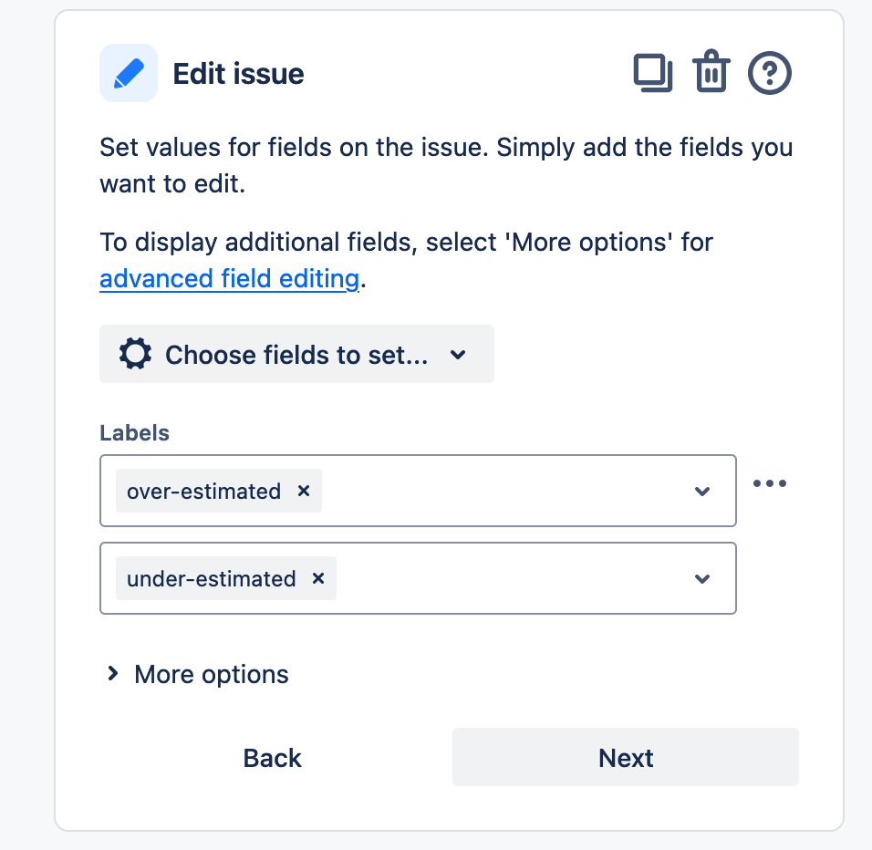

To ensure only the correct label is applied, when you edit the issue to add the new label you can also remove the old label
To do this
  1. Select the ADDREMOVE operation on the label fieldScreenshot 2024-06-24 at 15.55.57.png
  2. Enter "over-estimated" in the Values to add field
  3. Enter "under-estimated" in the Values to remove fieldScreenshot 2024-06-24 at 15.58.38.png
Now when the over-estimated label is added to an issue, if the under-estimated label is already on the issue. it will be removed.
You can then simply repeat these steps for the under-estimated logic, and you should be good to go.
