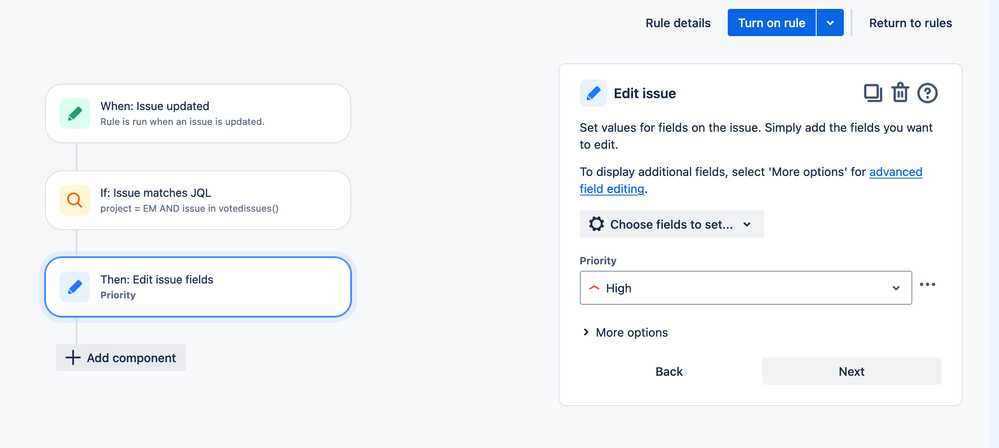

@Karolina Rucinska I was able to fetch something more:Screenshot 2024-11-01 at 11.48.24.png
As a workaround I have created an automation rule that is looking for the issues that have been voted on and based on that the priority is being changed. This happens when the issue gets updated.

This is what I have tried previously and it did not fetch the issues that have been voted on. I have now tried Jeroen's approach and it has worked. Thank you though!

You are right...it doesn't....my bad. Apologies. @Karolina Rucinska  please refer to @Jeroen Poismans answer
