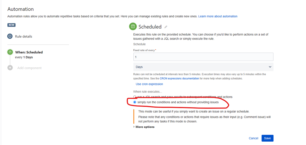

You can use the following Workaround if it suits you.
Instead of using the "Sprint Start" trigger, use the "Schedule" trigger.
Then set the following condition.
Sprint in openSprints() AND "Planned End Date" is EMPTY
Do the following action.
Planned Start Date: {{sprint.startDate}}
Planned End Date: {{sprint.endDate}}
Sprint Name: {{sprint.name}}
Let me know if you have any questions.
Andy Nabbs
June 24, 2025
unable to see schedule in triggers, is this a JQL trigger?
Gor Greyan
June 24, 2025
Hi @Andy Nabbs
You can set just the Schedule Issue Trigger, which will be simply run with condition.
Then you can set the conditions thatimage.png I have provided.
