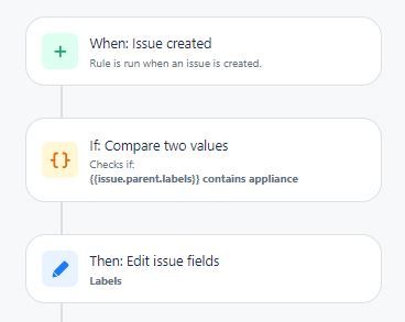

For your first case, this template of a rule may help:
  • trigger: issue created
  • action: re-fetch issue (I recommend always adding this after the Issue Created trigger to prevent timing / racetrack problems.)
  • smart values condition: check if the parent label is present
    • first value: {{issue.parent.labels}}
    • condition: contains
    • second value: label1
  • action: edit issue
    • select the labels field from the dropdown, and at the right under ... select ADDREMOVE
    • then add label1 in the Values to add field

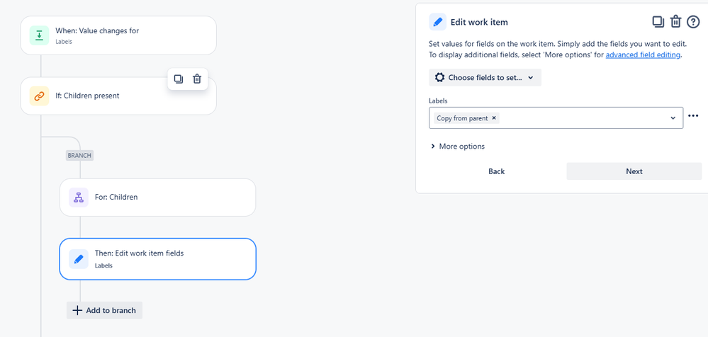

Hi Bill Sheboy,
I’ve created a separate rule for handling this, and it’s working fine. However, my main requirement is that no labels should be removed from the child issue when the parent is changed or when the labels on the parent issue are updated. I want the child to keep all its existing labels, even if some labels are removed from the parent.
Can you help me in this.
Bill Sheboy
May 27, 2025
Hi @Sundram Trivedi
As this is a very old thread, please create a new question using the "Ask a question" link at the top of the page.
Until we see your new question...If you read the other posts in this thread you will note using the ... ADDREMOVE option at the right side of the field.  As you want to add the parent's label values, those would need to be added with either the trigger issues smart value or using the Lookup Issues action to get them first.  I recommend experimenting to confirm which is needed.

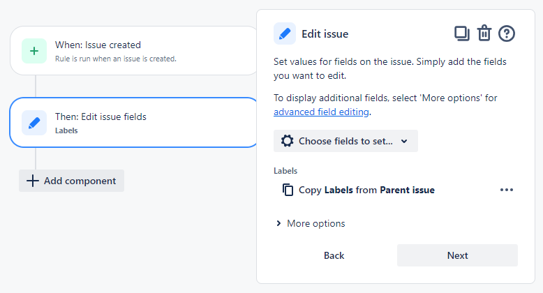

Hey @anne_gerten
Automations are absolutely the right choice for this! Let's go through building this automation for you.
  1. TRIGGER: Issue created
  2. THEN: Add an action: Edit issue
    1. For the fields choose "labels"
    2. Next to the text field click on the ... then choose Copy
    3. Click on the Copy labels from Current issue and change Current Issue to Parent
Here is a screenshot too:
anne_gerten
June 28, 2024
This worked for me. Thanks everybody.
