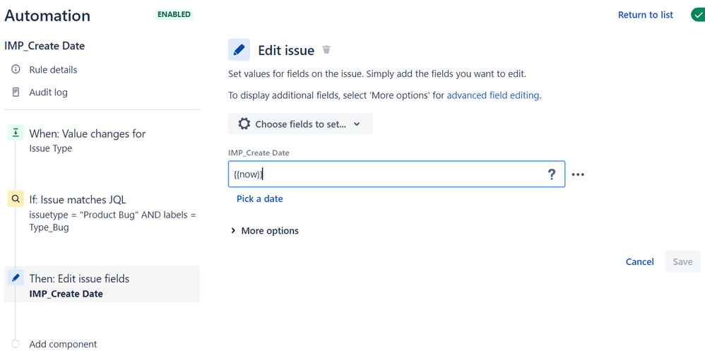

Hi Jack, Thanks for Your quick response on this and The workaround you suggested is awesome. I got struck in the Process. For the second rule , in Action when I set Date field, I have took this Automation as attached below. But It was throwing me error for that Automation. Can you look into it once.Automation Error.PNGAutomation.PNG

My guess is that the IMP Create Date is not associated with the screens of the project. Do you have multiple custom fields of the same name? Can you go verify this under the administration section then issues than custom fields? If you do, as the error seems to indicate, then it is possible you are choosing the wrong one for your project. As a test, you might want to simply add the date into a comment in the automation rule just to see if everything else is working OK. However ultimately we need to figure out your custom date field.

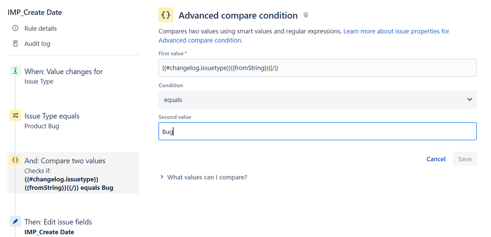

Issue got resolved. I have changed automation rule so that a single automation rule achieves the Usecase.
Attaching screenshot for your reference.
