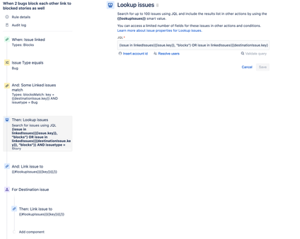

When you're liking 2 risks issues you could try something like this (I've used the bug issue type in replacement of risk and the story issue type to replace feature)
  1. Trigger the automation when a specific link type occurs (if this link type only occures between 2 risk issues you might be able to skip the next two conditions)
  2. Check if the issue type is a risk issue using the issue field condition(I've used bug in the example)
  3. Check if the destination issue (the issue that was linked) is a risk issue as well using a related issue condition. You want to check if linked issues with link type exposes risk has some issues that match JQL. The JQL would look something like this key = {{destinationIssue.key}} AND issuetype = Risk
  4. If all the condition above are met (meaning both issues are a risk issue) then perform a lookup issue. The JQL will look something like this (issue in linkedIssues({{issue.key}}, "blocks") OR issue in linkedIssues({{destinationIssue.key}}, "blocks")) AND issuetype = Feature
  5. Use the link issue action and input the smart value from the lookup issues action {{#lookupIssues}}{{key}}{{/}}
  6. Branch the rule for the destination issue
  7. Again use the link issue action with the same JQL
The reason I put 2 link issue actions is I assumed that each risk could have a feature linked so you would want to update both risk issues with the missing feature link.
