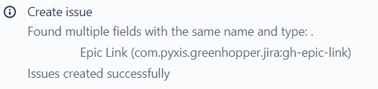

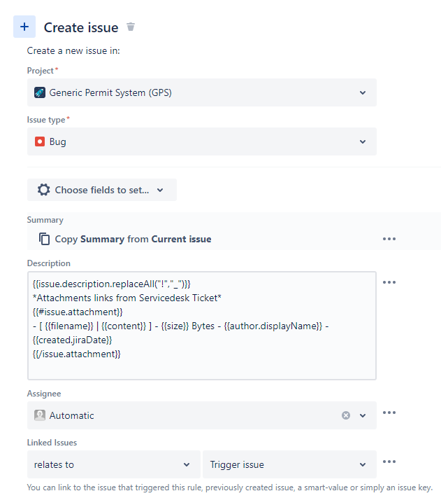

I have created an automation rule to create a new issue.
I have included the Epic link field.
When the rule is executed I get this error:
and the epic is not linked to the newly created issue.
What am I doing wrong here?

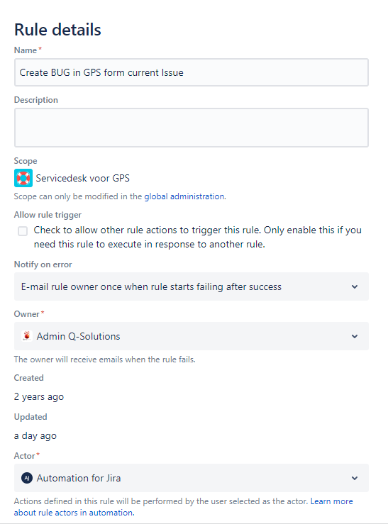

This happens when someone creates another Custom Field with the same name. This could have been done on a Team-managed project. Is your rule a Global rule? Or a Single or Multiple Project rule?
Kees Vianen
February 7, 2023
It is a single project rule for a JIRA Service Management project.
The issue that is created is created in another project which is a JIRA Software project.
The usecase is to create a bug in the developers project from a reported incident.

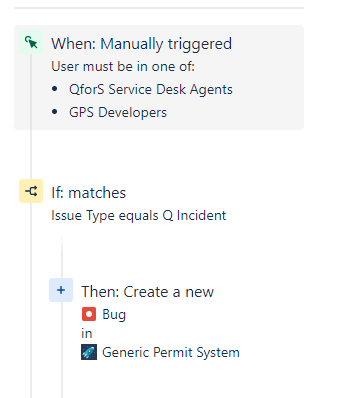

Can you share the entire rule?
Kees Vianen
February 7, 2023
Here it is:

The Automation rule looks fine, you will need to get your admins to get rid of the duplicated field - just rename it, no need to delete it.

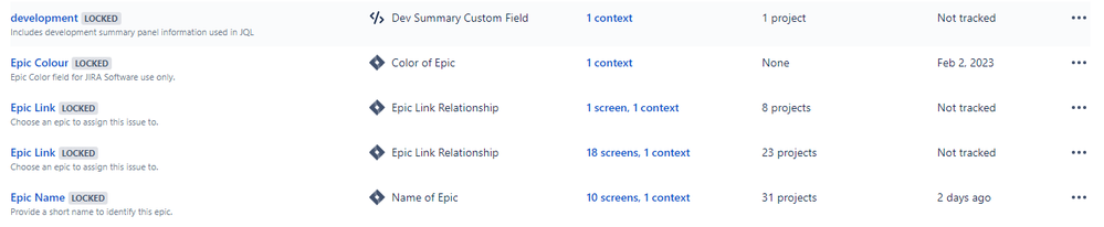

I see only one:

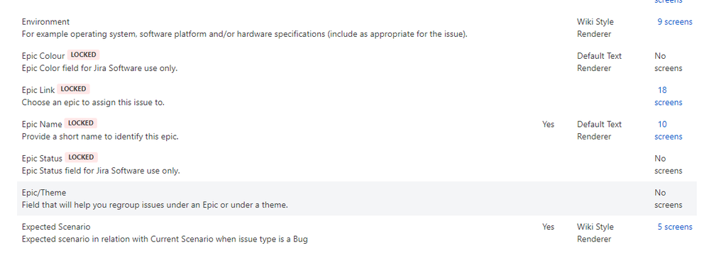

Kees Vianen
February 8, 2023
Logged in as admin and checked the custom fields. Now I see 2 but both are locked.
How can I rename a locked field?
John Funk
February 8, 2023
Yikes - never seen that before. That's probably going to take a support ticket with Atlassian.

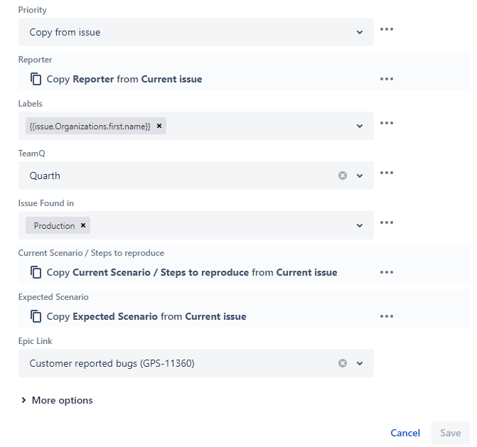

In the meantime, you might try updating the field using the Advanced feature.
In the rule, click the More options with the down caret beside it.
Replace everything in there with:
"fields": {
"{{issue.customfield_10009": "GPS-11360"}
Where 10009 is the Epic Link ID for the Epic you are using. To see that click on the 3 dots menu to the right and select View field information. The ID will be in the URL. I would try the one that has the most screens and projects already used by it.
And then take out the field update that you have now for it.
But you should still open the support ticket.
Finally, some of your field updates look like they are just copying over themselves. Copying a value from a field to the same field in the same issue doesn't see to be doing any good to me. Did you meant to copy from the Trigger issue? If so, click the words Current Issue and then change to Trigger Issue.

I have succesfully implemented the workaround. After some trial and error I found that it had to be like this:
"fields": {
"customfield_11100": "GPS-11360"
Now I will raise an issue with Atlassian support.
