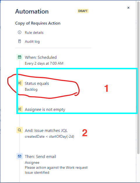

Here is the latest version

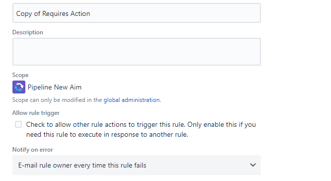

What is the Scope of your Rule (from the Rule Details tab)?

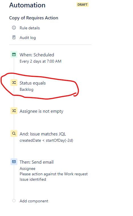

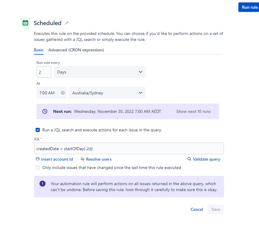

Dave Symonds
November 28, 2022

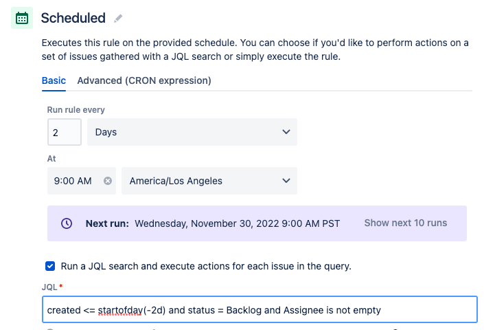

You don't need the three conditions after the trigger.
The first two conditions (indicated by "1") can be incorporated into the JQL statement in the trigger.
The third condition (indicated by "2") is already in the trigger. You don't need to have that there at all.
If there are less than 1000 issues in the project that meet all three conditions, your rule should not be throttled.
